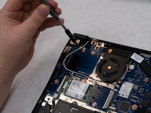

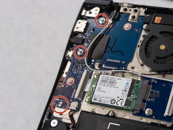

  3. Samsung ATIV Book 9 Lite Audio Port Replacement: crwdns2935265:03crwdnd2935265:01crwdnd2935265:03crwdne2935265:0 Samsung ATIV Book 9 Lite Audio Port Replacement: crwdns2935265:03crwdnd2935265:02crwdnd2935265:03crwdne2935265:0 Samsung ATIV Book 9 Lite Audio Port Replacement: crwdns2935265:03crwdnd2935265:03crwdnd2935265:03crwdne2935265:0
    • Using your hands move the black and white wires that are layered on top of the board to be out of the way of the removal.
    • Using a Phillips #0, remove three 3.5mm screws.
  4. Samsung ATIV Book 9 Lite Audio Port Replacement: crwdns2935265:04crwdnd2935265:01crwdnd2935265:02crwdne2935265:0 Samsung ATIV Book 9 Lite Audio Port Replacement: crwdns2935265:04crwdnd2935265:02crwdnd2935265:02crwdne2935265:0
    • Using your hands remove the cord that connects the speakers to the board you are removing.
    • Do not pull on the cord as that might damage it; remove it by pulling on the white wire head.
    • Using your hands, remove the board from the computer.
