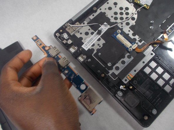

    • Remove the ten 5 mm screws that hold the backplate using the Phillips #000 screwdriver.
  2. Samsung ATIV Book 7 NP740U3E-K01UB USB Ports Replacement: crwdns2935265:02crwdnd2935265:01crwdnd2935265:01crwdne2935265:0
    • Remove the backplate.
  3. Samsung ATIV Book 7 NP740U3E-K01UB USB Ports Replacement, Battery: crwdns2935265:03crwdnd2935265:01crwdnd2935265:01crwdne2935265:0
    • Remove the six 5mm screws that hold the battery by using the Phillips #0 screwdriver.
  4. Samsung ATIV Book 7 NP740U3E-K01UB USB Ports Replacement: crwdns2935265:04crwdnd2935265:01crwdnd2935265:01crwdne2935265:0
    • Disconnect the battery from the motherboard and remove the battery.
  5. Samsung ATIV Book 7 NP740U3E-K01UB USB Ports Replacement, USB Ports: crwdns2935265:05crwdnd2935265:01crwdnd2935265:02crwdne2935265:0 Samsung ATIV Book 7 NP740U3E-K01UB USB Ports Replacement, USB Ports: crwdns2935265:05crwdnd2935265:02crwdnd2935265:02crwdne2935265:0
    • Disconnect the ribbon connecting the motherboard with the USB ports .
    • Disconnect the speaker from the board
  6. Samsung ATIV Book 7 NP740U3E-K01UB USB Ports Replacement: crwdns2935265:06crwdnd2935265:01crwdnd2935265:02crwdne2935265:0 Samsung ATIV Book 7 NP740U3E-K01UB USB Ports Replacement: crwdns2935265:06crwdnd2935265:02crwdnd2935265:02crwdne2935265:0
    • Unscrew the 5mm screws with the Phillips #0 screw driver.
    • Lift the board out of the laptop.
