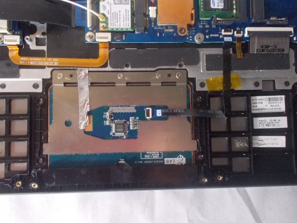

  5. Samsung ATIV Book 7 NP740U3E-K01UB Track Pad Replacement, Track Pad: crwdns2935265:05crwdnd2935265:01crwdnd2935265:01crwdne2935265:0
    • Disconnect the track pad from the motherboard.
  6. Samsung ATIV Book 7 NP740U3E-K01UB Track Pad Replacement: crwdns2935265:06crwdnd2935265:01crwdnd2935265:02crwdne2935265:0 Samsung ATIV Book 7 NP740U3E-K01UB Track Pad Replacement: crwdns2935265:06crwdnd2935265:02crwdnd2935265:02crwdne2935265:0
    • Peel the tape on the track pad back.
    • Unscrew the five 2mm screws with the Phillips #0 screwdriver.
    • Rotate the track pad out of the case.
