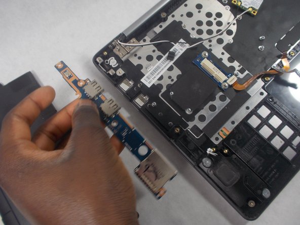

    • Remove the ten 5 mm screws that hold the backplate using the Phillips #000 screwdriver.
  2. Samsung ATIV Book 7 NP740U3E-K01UB Speaker Replacement: crwdns2935265:02crwdnd2935265:01crwdnd2935265:01crwdne2935265:0
    • Remove the backplate.
  3. Samsung ATIV Book 7 NP740U3E-K01UB Speaker Replacement, Battery: crwdns2935265:03crwdnd2935265:01crwdnd2935265:01crwdne2935265:0
    • Remove the six 5mm screws that hold the battery by using the Phillips #0 screwdriver.
  4. Samsung ATIV Book 7 NP740U3E-K01UB Speaker Replacement: crwdns2935265:04crwdnd2935265:01crwdnd2935265:01crwdne2935265:0
    • Disconnect the battery from the motherboard and remove the battery.
  5. Samsung ATIV Book 7 NP740U3E-K01UB Speaker Replacement, Speaker: crwdns2935265:05crwdnd2935265:01crwdnd2935265:01crwdne2935265:0
    • There are two speakers which are found on the lower left and right side of the laptop, beside the battery.
  6. Samsung ATIV Book 7 NP740U3E-K01UB Speaker Replacement: crwdns2935265:06crwdnd2935265:01crwdnd2935265:03crwdne2935265:0 Samsung ATIV Book 7 NP740U3E-K01UB Speaker Replacement: crwdns2935265:06crwdnd2935265:02crwdnd2935265:03crwdne2935265:0 Samsung ATIV Book 7 NP740U3E-K01UB Speaker Replacement: crwdns2935265:06crwdnd2935265:03crwdnd2935265:03crwdne2935265:0
    • Remove the screws of the motherboard to disconnect the motherboard from the speakers using a Phillips #0 screwdriver.
  7. Samsung ATIV Book 7 NP740U3E-K01UB Speaker Replacement: crwdns2935265:07crwdnd2935265:01crwdnd2935265:01crwdne2935265:0
    • Remove the 4 mm screw with the Phillips #000 screwdriver and remove the speaker.
