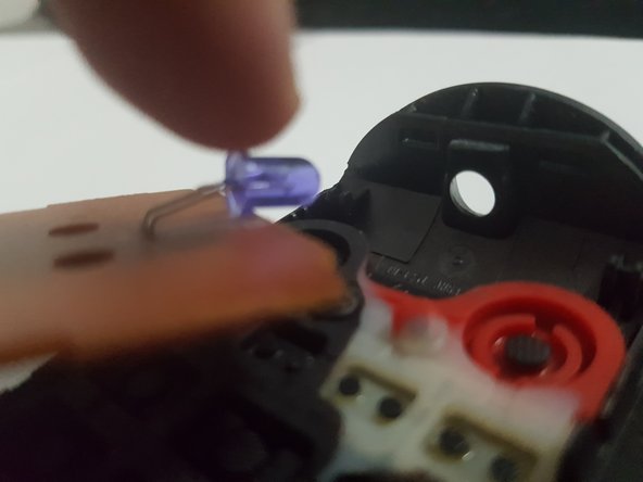

    • Separate the front and back case with your hands. Grip it by the seam and open it up gently.
  2. Samsung AH59-02408A Motherboard Replacement: crwdns2935265:02crwdnd2935265:01crwdnd2935265:03crwdne2935265:0 Samsung AH59-02408A Motherboard Replacement: crwdns2935265:02crwdnd2935265:02crwdnd2935265:03crwdne2935265:0 Samsung AH59-02408A Motherboard Replacement: crwdns2935265:02crwdnd2935265:03crwdnd2935265:03crwdne2935265:0
    • Identify whether the circuit board is secured to the keypad or the back plate.
    • Pull out the circuit board from the sockets in the back case.
  3. Samsung AH59-02408A Motherboard Replacement: crwdns2935265:03crwdnd2935265:01crwdnd2935265:03crwdne2935265:0 Samsung AH59-02408A Motherboard Replacement: crwdns2935265:03crwdnd2935265:02crwdnd2935265:03crwdne2935265:0 Samsung AH59-02408A Motherboard Replacement: crwdns2935265:03crwdnd2935265:03crwdnd2935265:03crwdne2935265:0
    • Remove the circuit board connectors from the keypad.
  4. Samsung AH59-02408A Motherboard Replacement: crwdns2935265:04crwdnd2935265:01crwdnd2935265:03crwdne2935265:0 Samsung AH59-02408A Motherboard Replacement: crwdns2935265:04crwdnd2935265:02crwdnd2935265:03crwdne2935265:0 Samsung AH59-02408A Motherboard Replacement: crwdns2935265:04crwdnd2935265:03crwdnd2935265:03crwdne2935265:0

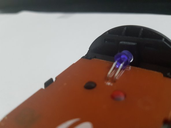

    • To complete the replacement, follow the steps in reverse order using your new circuit board.
    • Ensure that your Circuit Board's LED bulb is inserted into your front plate's socket as labelled. Otherwise your remote will not function.
