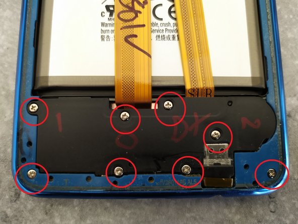

  3. Samsung A7 (2018) SM-A750FN  Display  Replacement, Remove mid-frame: crwdns2935265:03crwdnd2935265:01crwdnd2935265:02crwdne2935265:0 Samsung A7 (2018) SM-A750FN  Display  Replacement, Remove mid-frame: crwdns2935265:03crwdnd2935265:02crwdnd2935265:02crwdne2935265:0
    • Remove the 7 screws on the upper half of the frame.
    • Remove the 8 screws on the lower half of the frame.
    • The frame can now be removed by pushing it away from the screen. It is held in place by little clips.
    • If the screen does not come lose, insert a plastic pick or spudger to release the frame.

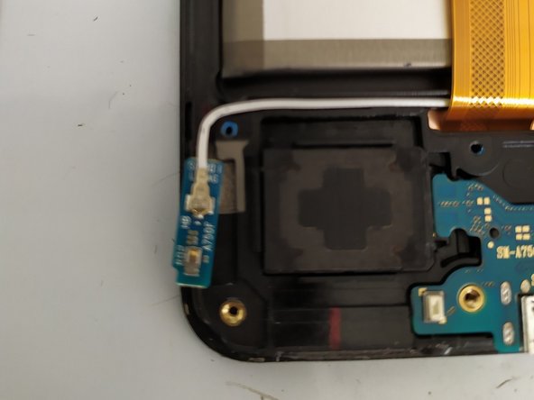

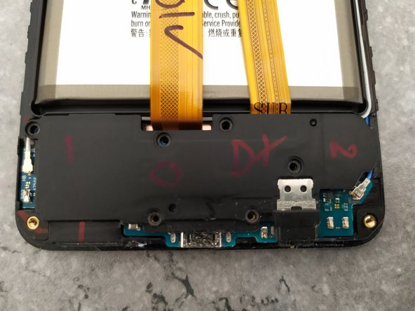

  4. Samsung A7 (2018) SM-A750FN  Display  Replacement, Disconnect battery: crwdns2935265:04crwdnd2935265:01crwdnd2935265:03crwdne2935265:0 Samsung A7 (2018) SM-A750FN  Display  Replacement, Disconnect battery: crwdns2935265:04crwdnd2935265:02crwdnd2935265:03crwdne2935265:0 Samsung A7 (2018) SM-A750FN  Display  Replacement, Disconnect battery: crwdns2935265:04crwdnd2935265:03crwdnd2935265:03crwdne2935265:0
    • Disconnect the battery.
    • Remove the black plastic cover from the daughter board
    • On the left side of the daughter board is another small board. This can either be pried loose and removed or the cable can be disconnected.

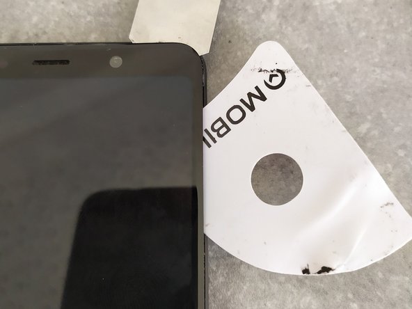

  6. Samsung A7 (2018) SM-A750FN  Display  Replacement, Display removal: crwdns2935265:06crwdnd2935265:01crwdnd2935265:03crwdne2935265:0 Samsung A7 (2018) SM-A750FN  Display  Replacement, Display removal: crwdns2935265:06crwdnd2935265:02crwdnd2935265:03crwdne2935265:0 Samsung A7 (2018) SM-A750FN  Display  Replacement, Display removal: crwdns2935265:06crwdnd2935265:03crwdnd2935265:03crwdne2935265:0
    • Use a heat gun to heat up the front of the display.
    • Insert a thin tooll between the glass and the frame to create a small gap.
    • Insert a plastic tool and work around the edge of the glass to separate the display from the frame.
    • The LCD is also glued, so it is difficult to remove the glass without breaking the LCD. For this guide, replacement of the glass and LCD was conducted.
    • Once the screen has been removed, remove any excess adhesive from the frame.
    • Insert the display cable through the hole. Connect it to the mainboard and test it before glueing it to the frame.
