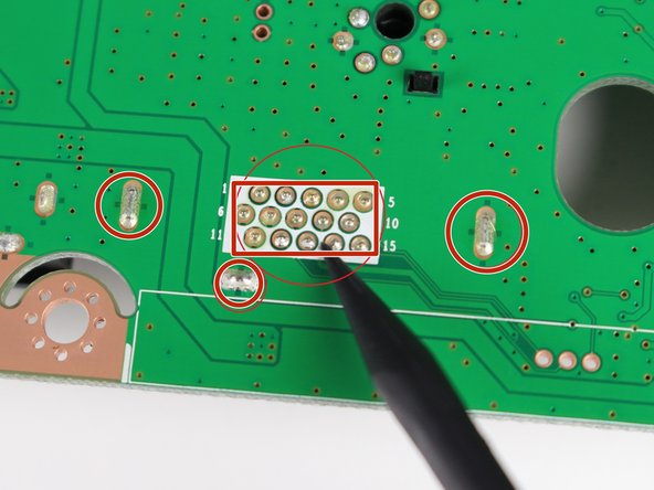

  9. Samsung 27E510C VGA Port Replacement: crwdns2935265:09crwdnd2935265:01crwdnd2935265:02crwdne2935265:0 Samsung 27E510C VGA Port Replacement: crwdns2935265:09crwdnd2935265:02crwdnd2935265:02crwdne2935265:0
    • Desolder the four regions in the area indicated on the back side of the motherboard using a soldering iron and some desoldering wick.
    • The VGA Port should fall off the board if all of the solder is removed.
  10. Samsung 27E510C VGA Port Replacement: crwdns2935265:010crwdnd2935265:01crwdnd2935265:01crwdne2935265:0
    • If the VGA Port does not fall off the board, try tugging on it with your hand.
    • The VGA Port may be too hot to touch right after desoldering.
    • Excessive tugging could damage the motherboard.
