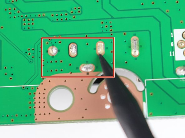

  8. Samsung 27E510C Power Adapter Port Replacement, Power Adapter Port: crwdns2935265:08crwdnd2935265:01crwdnd2935265:02crwdne2935265:0 Samsung 27E510C Power Adapter Port Replacement, Power Adapter Port: crwdns2935265:08crwdnd2935265:02crwdnd2935265:02crwdne2935265:0
    • Desolder the indicated leads on the back of the motherboard.
    • The power adapter port should fall out of the board after the solder is removed.
  9. Samsung 27E510C Power Adapter Port Replacement: crwdns2935265:09crwdnd2935265:01crwdnd2935265:01crwdne2935265:0
    • If the power adapter port does not fall out of the board, try tugging on it with your hand.
    • The power adapter port may be too hot to touch right after desoldering.
    • Excessive tugging could damage the motherboard.
