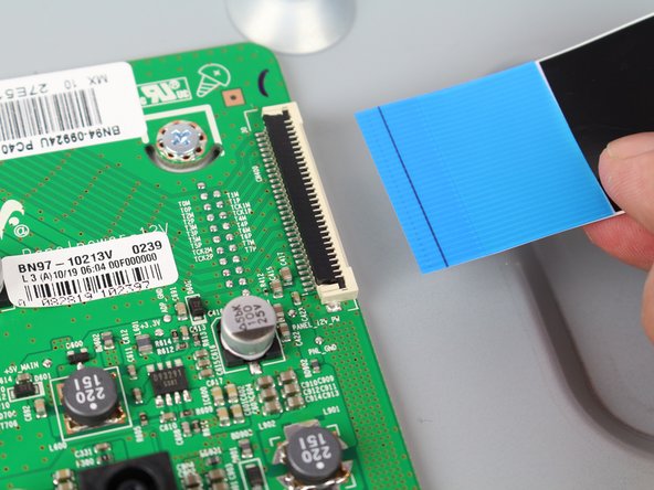

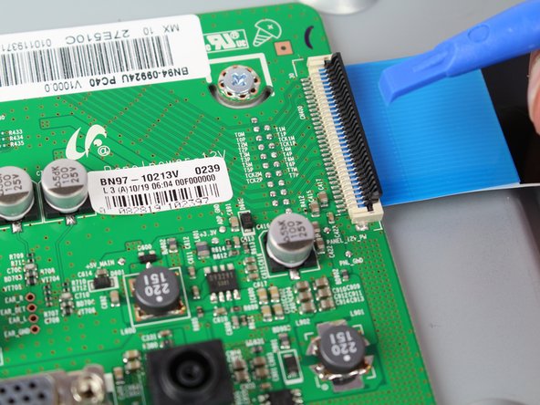

  5. Samsung 27E510C Motherboard Replacement: crwdns2935265:05crwdnd2935265:01crwdnd2935265:03crwdne2935265:0 Samsung 27E510C Motherboard Replacement: crwdns2935265:05crwdnd2935265:02crwdnd2935265:03crwdne2935265:0 Samsung 27E510C Motherboard Replacement: crwdns2935265:05crwdnd2935265:03crwdnd2935265:03crwdne2935265:0
    • For the ribbon cable, Lift the tab from the side facing the inside of the mother board with your fingernail or a spudger.
    • Remove the cable by pulling while lifting slightly.
    • If the cable does not come out easily, than the secure tab may not be fully opened.
