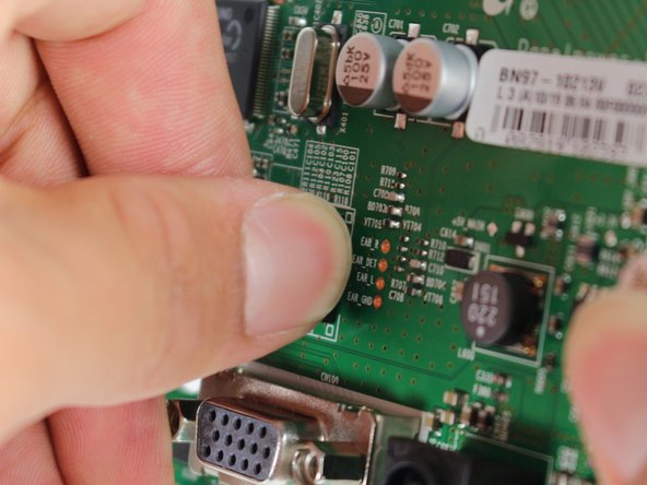

    • Remove each of the 5mm length screws attaching the motherboard to the body of the monitor using a #1 Phillips head screwdriver.
  7. Samsung 27E510C Audio Jack Replacement: crwdns2935265:07crwdnd2935265:01crwdnd2935265:02crwdne2935265:0 Samsung 27E510C Audio Jack Replacement: crwdns2935265:07crwdnd2935265:02crwdnd2935265:02crwdne2935265:0
    • Using both hands, lift the board off of the monitor body by the motherboards base.

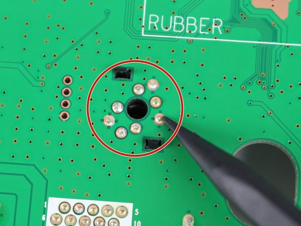

  8. Samsung 27E510C Audio Jack Replacement, Audio Jack: crwdns2935265:08crwdnd2935265:01crwdnd2935265:02crwdne2935265:0 Samsung 27E510C Audio Jack Replacement, Audio Jack: crwdns2935265:08crwdnd2935265:02crwdnd2935265:02crwdne2935265:0
    • Desolder each of the indicated leads on the back of the motherboard.
  9. Samsung 27E510C Audio Jack Replacement: crwdns2935265:09crwdnd2935265:01crwdnd2935265:02crwdne2935265:0 Samsung 27E510C Audio Jack Replacement: crwdns2935265:09crwdnd2935265:02crwdnd2935265:02crwdne2935265:0
    • Squeeze the rear tabs located on the back of the motherboard with your thumb and index finger.
    • While squeezing both tabs, pull the audio jack out from the front of the motherboard.
    • The audio jack may be too hot to touch right after desoldering.
