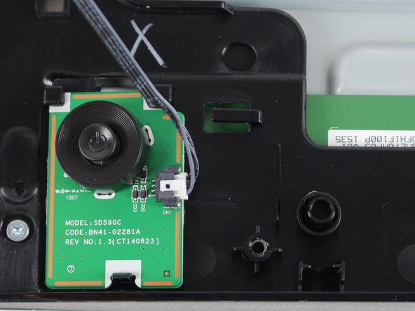

  4. Samsung 27E510C  NAV Button Replacement: crwdns2935265:04crwdnd2935265:01crwdnd2935265:01crwdne2935265:0
    • Disconnect the navigation button from the motherboard by holding down the thumb tab and pulling its connector out.
  5. Samsung 27E510C  NAV Button Replacement: crwdns2935265:05crwdnd2935265:01crwdnd2935265:02crwdne2935265:0 Samsung 27E510C  NAV Button Replacement: crwdns2935265:05crwdnd2935265:02crwdnd2935265:02crwdne2935265:0
    • Remove the navigation buttons connector wire from the monitors body tab.
  6. Samsung 27E510C  NAV Button Replacement: crwdns2935265:06crwdnd2935265:01crwdnd2935265:01crwdne2935265:0
    • With one thumb, hold down the tab on the bottom of the navigation buttons base.
    • While holding the tab down, lift the base of the navigation button with your other hand.

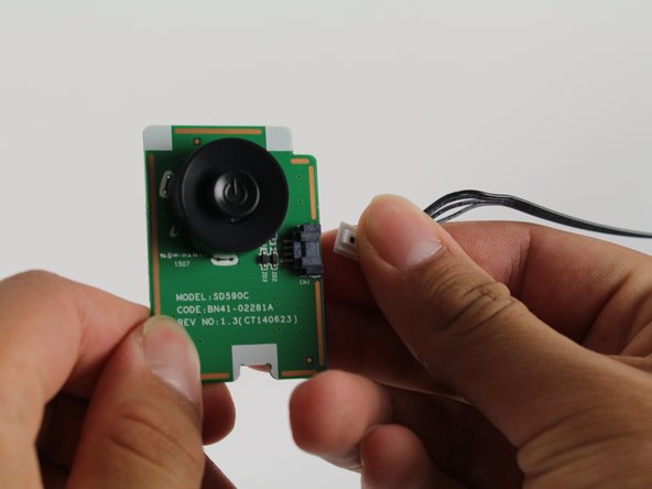

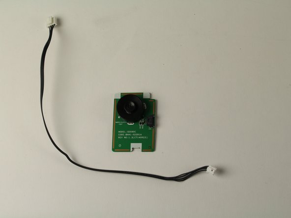

  7. Samsung 27E510C  NAV Button Replacement: crwdns2935265:07crwdnd2935265:01crwdnd2935265:03crwdne2935265:0 Samsung 27E510C  NAV Button Replacement: crwdns2935265:07crwdnd2935265:02crwdnd2935265:03crwdne2935265:0 Samsung 27E510C  NAV Button Replacement: crwdns2935265:07crwdnd2935265:03crwdnd2935265:03crwdne2935265:0
    • Remove the connector wire from the defective navigation button by first gripping its connectors thumb tab.
    • While gripping the thumb tab, pull the connector from the base of the navigation button.
    • You can save the connector wire since it may not be defective.
