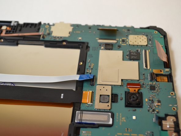

    • Remove the three green pieces of tape covering the white, black, and gold ribbon cables.
    • Use a spudger to flip up the retaining flap on the three ribbon cable ZIF sockets.
    • Pull the ribbon cables out of the sockets.

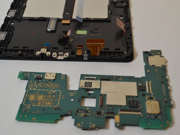

    • Remove the green protective tape from the three ZIF connectors on the motherboard.
    • Pull the ribbon cables out of their sockets.
  5. Samsubg Galaxy Tab A 10.1 S-Pen Home Button Replacement: crwdns2935265:05crwdnd2935265:01crwdnd2935265:02crwdne2935265:0 Samsubg Galaxy Tab A 10.1 S-Pen Home Button Replacement: crwdns2935265:05crwdnd2935265:02crwdnd2935265:02crwdne2935265:0
    • Remove the six 4mm Phillips #000 screws from the motherboard.
    • Remove the motherboard.

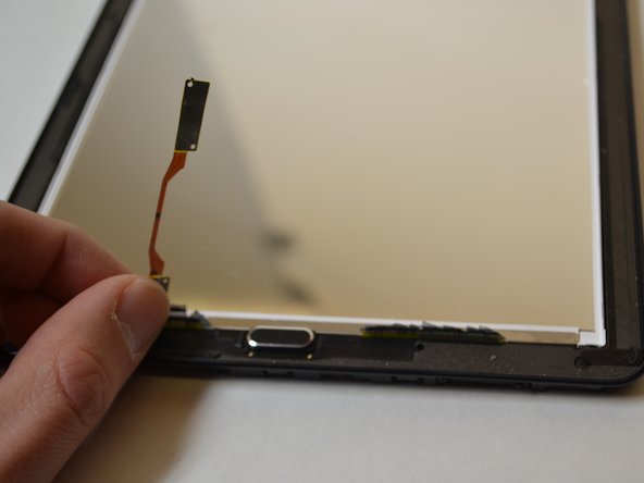

  7. Samsubg Galaxy Tab A 10.1 S-Pen Home Button Replacement: crwdns2935265:07crwdnd2935265:01crwdnd2935265:02crwdne2935265:0 Samsubg Galaxy Tab A 10.1 S-Pen Home Button Replacement: crwdns2935265:07crwdnd2935265:02crwdnd2935265:02crwdne2935265:0
    • Locate the Home button on the front of the panel and carefully lift the gold ribbon surrounding it from RIGHT to LEFT.

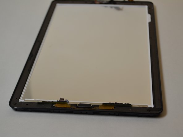

  8. Samsubg Galaxy Tab A 10.1 S-Pen Home Button Replacement: crwdns2935265:08crwdnd2935265:01crwdnd2935265:01crwdne2935265:0
    • Using your Phillips #000 screwdriver Remove the two 4mm Phillips #000 screws from the home button.
  9. Samsubg Galaxy Tab A 10.1 S-Pen Home Button Replacement: crwdns2935265:09crwdnd2935265:01crwdnd2935265:01crwdne2935265:0
    • Remove the home button by sliding it to the left or right while pulling up.
