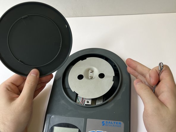

  4. Salter Brecknell Model 311 Disassembly, Remove aesthetic top cover: crwdns2935265:04crwdnd2935265:01crwdnd2935265:02crwdne2935265:0 Salter Brecknell Model 311 Disassembly, Remove aesthetic top cover: crwdns2935265:04crwdnd2935265:02crwdnd2935265:02crwdne2935265:0
    • Remove the weighing platform by unscrewing carefully.
    • Rotate it about 60 degrees so that it can be lifted vertically.

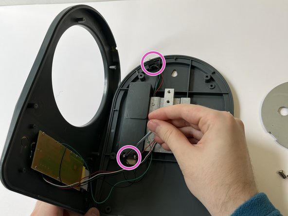

  5. Salter Brecknell Model 311 Disassembly, Split Open Plastic Shell: crwdns2935265:05crwdnd2935265:01crwdnd2935265:01crwdne2935265:0
    • Gently tap the side of the upper plastic half, be careful as it can be snapped easily.
    • There are two clips that attach the upper half to the bottom half.
    • Be careful to avoid breaking the clips off.
  6. Salter Brecknell Model 311 Disassembly, Remove Central Screws: crwdns2935265:06crwdnd2935265:01crwdnd2935265:01crwdne2935265:0
    • Remove the two central screws, connecting the scale weight.
    • The tightness of the screws can affect the scale's accuracy, so it is important to take note of this.
  7. Salter Brecknell Model 311 Disassembly, Separate the Plastic Shell: crwdns2935265:07crwdnd2935265:01crwdnd2935265:01crwdne2935265:0
    • Lift the top half of the plastic shell to the side. Be careful, as the electrical circuit board will connect both parts.
    • The wires are exceptionally thin, be careful to not rip them.
  8. Salter Brecknell Model 311 Disassembly, Inspect the wiring: crwdns2935265:08crwdnd2935265:01crwdnd2935265:02crwdne2935265:0 Salter Brecknell Model 311 Disassembly, Inspect the wiring: crwdns2935265:08crwdnd2935265:02crwdnd2935265:02crwdne2935265:0
    • Check for wiring issues connecting to components; look for torn cables.
    • Look for loose wires or connections. Every single wire should be fully attached at both ends.
