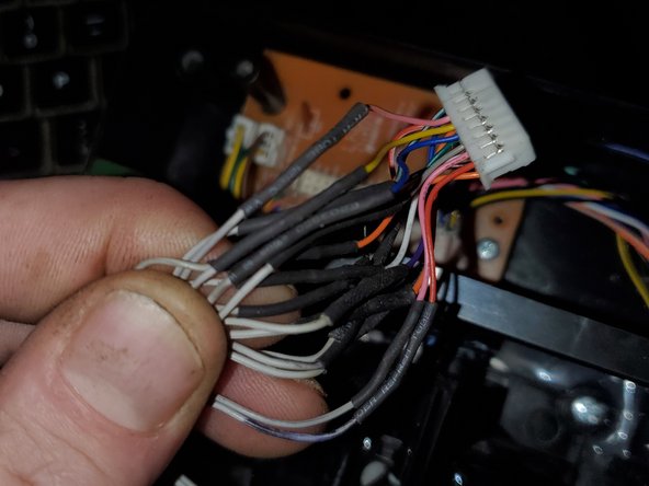

    • Grabbed an old IDE cable, and harvested the wire. kind of a pain to thread the wire through. In the end, I seperated 2 x 5 wire ribbon, 1x2 wire, and 1x3 wire. There are 2 posts in the shaft. The upper one likes to come out, but don't let it.(Edit, seperate all your wires if you're using ide ribbon. had to redo everything. because i didn't)
    • This metal shaft(circled), keeps on causing my wires to break.(also, logitech is being stingy on wire...) sick of soldering them back together, and the replacements I used where a bit thick, now can't find the broken wire, so replacing the whole thing.(wasn't a broken wire, but a loose contact in the plug but oh well. needed to be done)

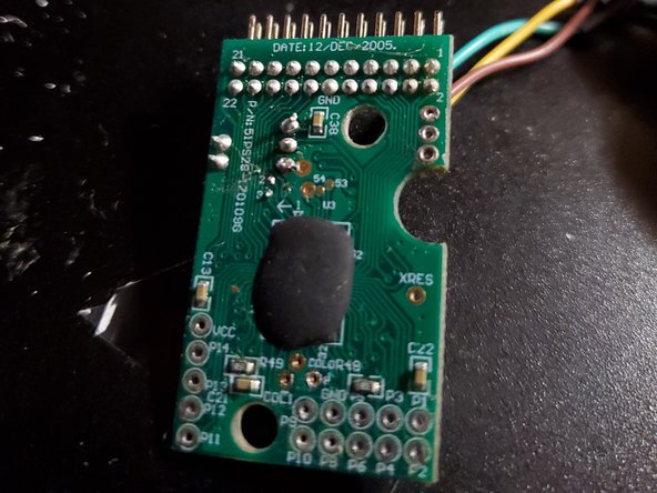

  10. Saitek/logitech X52 Pro/not pro Wiring Replacement: crwdns2935265:011crwdnd2935265:01crwdnd2935265:01crwdne2935265:0
    • pcb pinouts p5 on base pcb is actually on the other row, same position.

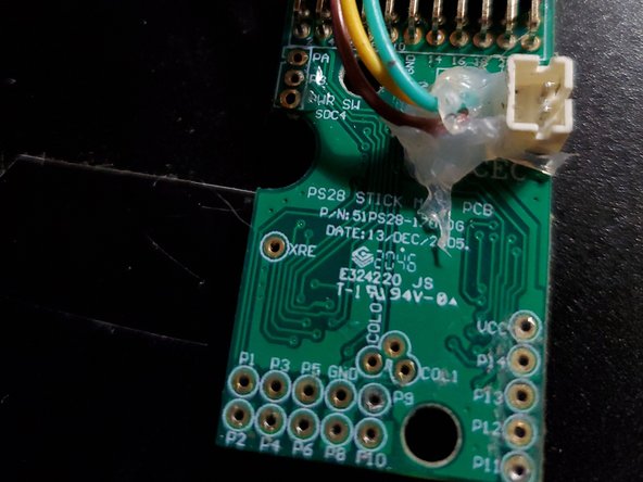

  11. Saitek/logitech X52 Pro/not pro Wiring Replacement: crwdns2935265:012crwdnd2935265:01crwdnd2935265:03crwdne2935265:0 Saitek/logitech X52 Pro/not pro Wiring Replacement: crwdns2935265:012crwdnd2935265:02crwdnd2935265:03crwdne2935265:0 Saitek/logitech X52 Pro/not pro Wiring Replacement: crwdns2935265:012crwdnd2935265:03crwdnd2935265:03crwdne2935265:0
    • finished. side note, the female end was actually loose, so had to remove from white plug and squeeze the contacts back together.(used a dental pick to lift the tab that holds the contact in place.
    • hot glue is very useful here, but not absolutely necessary. But I highly recommend for the shaft in the base as seen here.also doesn't hurt to hot glue the pcb wires as well(circled)
    • hot glue seen in base, is a previous repair.(circled yellow)
