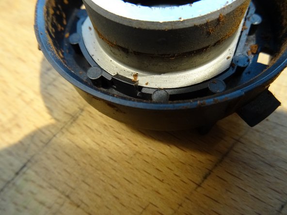

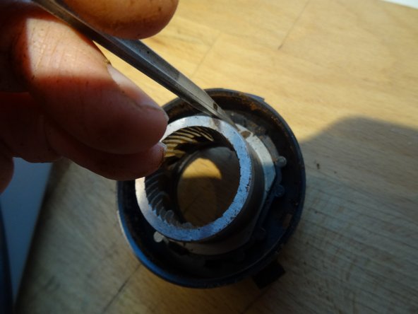

  8. Saeco Vienna Sup 018 Grindstones Replacement, Replace grinding ring: crwdns2935265:08crwdnd2935265:01crwdnd2935265:03crwdne2935265:0 Saeco Vienna Sup 018 Grindstones Replacement, Replace grinding ring: crwdns2935265:08crwdnd2935265:02crwdnd2935265:03crwdne2935265:0 Saeco Vienna Sup 018 Grindstones Replacement, Replace grinding ring: crwdns2935265:08crwdnd2935265:03crwdnd2935265:03crwdne2935265:0
    • The cap of the grinding ring can be removed by pushing the small notches alternately left and right with a screwdriver.
    • The grinding ring is fastened with clamps. Press with the screwdriver to the side, then the Mahlring can be solved.
    • Again, everything is cleaned well, then pressed the new ring and the lid put on.
