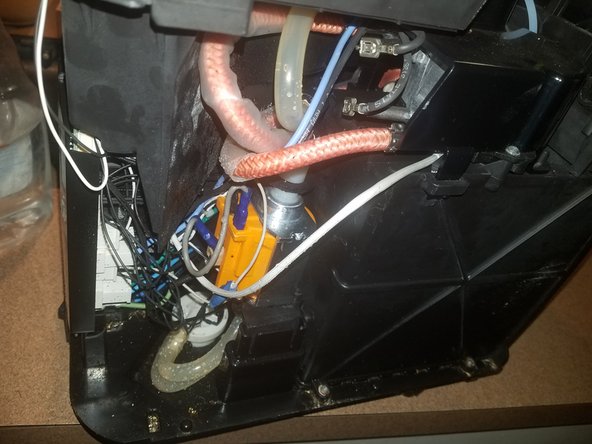

  4. Saeco Intelia Maintenance, Keep out bugs!: crwdns2935265:04crwdnd2935265:01crwdnd2935265:02crwdne2935265:0 Saeco Intelia Maintenance, Keep out bugs!: crwdns2935265:04crwdnd2935265:02crwdnd2935265:02crwdne2935265:0
    • Bugs invaded my machine because the cup warmer gave them a nice home. Unplug it nightly. To kill them use white vinegar so you wont poison yourself. (Those are only a few of the bugs in my machine last week)
