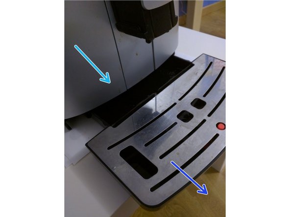

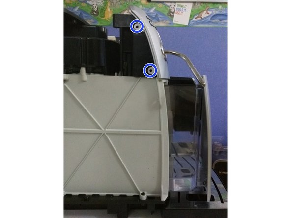

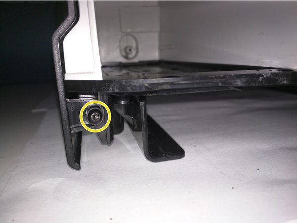

  3. Saeco Intelia HD8752 LCD Display Panel Replacement, Removing left side casing: crwdns2935265:03crwdnd2935265:01crwdnd2935265:03crwdne2935265:0 Saeco Intelia HD8752 LCD Display Panel Replacement, Removing left side casing: crwdns2935265:03crwdnd2935265:02crwdnd2935265:03crwdne2935265:0 Saeco Intelia HD8752 LCD Display Panel Replacement, Removing left side casing: crwdns2935265:03crwdnd2935265:03crwdnd2935265:03crwdne2935265:0
    • Remove the two screws on the top of the left panel.
    • Remove the drip tray.
    • Remove the water tank.
    • Below the water tank location, remove the bottom screw of the left side casing.
    • Remove the left side casing by pulling it gently. Take care of the nick, at the middle of the panel (above the yellow marked screw).
