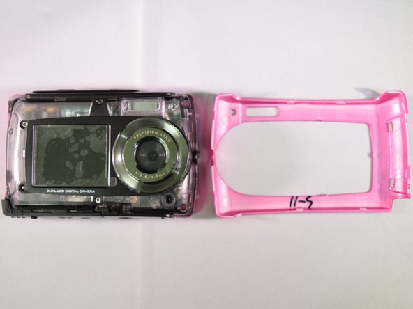

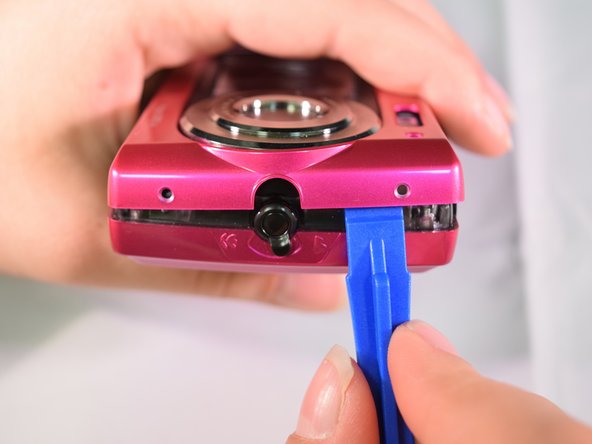

  3. SVP 5800 Back Casing Replacement: crwdns2935265:03crwdnd2935265:01crwdnd2935265:02crwdne2935265:0 SVP 5800 Back Casing Replacement: crwdns2935265:03crwdnd2935265:02crwdnd2935265:02crwdne2935265:0
    • Place the plastic opening tool on the crack between the front and back casings.
    • Apply pressure by pulling down on the plastic opening tool to pry the case apart.

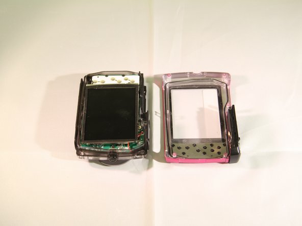

  4. SVP 5800 Back Casing Replacement: crwdns2935265:04crwdnd2935265:01crwdnd2935265:02crwdne2935265:0 SVP 5800 Back Casing Replacement: crwdns2935265:04crwdnd2935265:02crwdnd2935265:02crwdne2935265:0
    • Wedge your fingers in the opening and slowly pull the front casing away from the bottom casing until it complete separates from the device.
    • Using too much force in this step can damage your device.

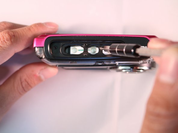

  5. SVP 5800 Back Casing Replacement, Top button Compartment: crwdns2935265:05crwdnd2935265:01crwdnd2935265:03crwdne2935265:0 SVP 5800 Back Casing Replacement, Top button Compartment: crwdns2935265:05crwdnd2935265:02crwdnd2935265:03crwdne2935265:0 SVP 5800 Back Casing Replacement, Top button Compartment: crwdns2935265:05crwdnd2935265:03crwdnd2935265:03crwdne2935265:0
    • Insert the flat end of wide metal spudger into the seam of the plastic buffer surrounding the buttons and pry it open.

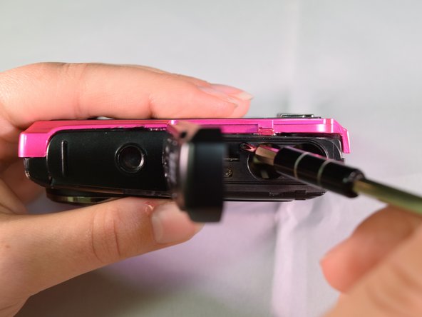

  6. SVP 5800 Back Casing Replacement: crwdns2935265:06crwdnd2935265:01crwdnd2935265:03crwdne2935265:0 SVP 5800 Back Casing Replacement: crwdns2935265:06crwdnd2935265:02crwdnd2935265:03crwdne2935265:0 SVP 5800 Back Casing Replacement: crwdns2935265:06crwdnd2935265:03crwdnd2935265:03crwdne2935265:0
    • Use A #00 Phillips head screwdriver and turn counterclockwise to remove the four indicated screws.
    • Set the screws aside.

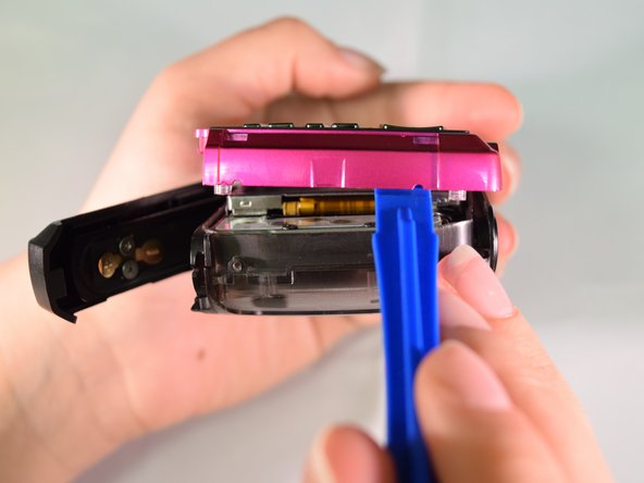

  9. SVP 5800 Back Casing Replacement: crwdns2935265:09crwdnd2935265:01crwdnd2935265:03crwdne2935265:0 SVP 5800 Back Casing Replacement: crwdns2935265:09crwdnd2935265:02crwdnd2935265:03crwdne2935265:0 SVP 5800 Back Casing Replacement: crwdns2935265:09crwdnd2935265:03crwdnd2935265:03crwdne2935265:0
    • Slide the flat edge of the plastic opening tool between the inner casing and the back outer casing.
    • Push up on the plastic opening tool so that the back casing starts to lift from the inner casing.
    • Lifting the casing too far may result in damage. Lift the casing slowly.
