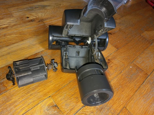

    • Here is a photo of the entire unit fully disassembled. Most of the hair we need to get at is inside the ends of the brush axle (bottom left of photo).
    • I recommend using a medium-large safety pin to dig out the hair/fibres, a pair of scissors to cut the hair off of the brush, and a flat head screw driver to pry the black plastic end caps off with. You may need a small hammer for reassembly.
    • There are no screws. Most pieces are held together by plastic pressure. Be careful not to break any plastic clips or pieces or you will need to buy a new unit.
    • To prevent having to disassemble this unit often, always take a few minutes to cut any hair/fibre off of the brush after each use.
    • Disassembly and cleaning should take from 30-45 minutes, depending on how much hair is stuck in the unit.

  3. STB-101 Miele Turbo Mini TurboBrush Disassembly and Cleaning, Remove Fin Assembly: crwdns2935265:03crwdnd2935265:01crwdnd2935265:01crwdne2935265:0
    • Now we remove the part that makes the unit spin. The fins are pulled by the vacuum suction and rotate the belt that moves the brush. To remove the Fin assembly, gently squeeze the little black plastic clips on either side. This does not take much force, do it gently as if you break the clips there is no way to repair them.

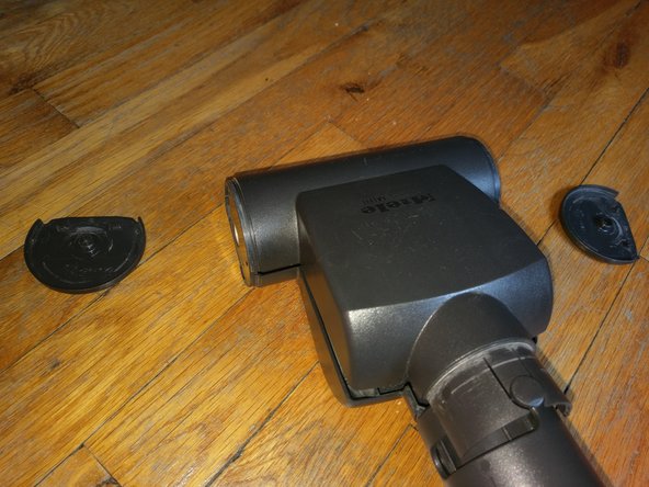

  4. STB-101 Miele Turbo Mini TurboBrush Disassembly and Cleaning, Remove End Caps: crwdns2935265:04crwdnd2935265:01crwdnd2935265:01crwdne2935265:0
    • This is probably the hardest part of the disassembly, certainly the least intuitive. The end caps hold the whole unit together and are just popped in. Gently pry them off pulling them by hand, rotating as much as you can, and then using a small flat-headed screwdriver to pry them off. This will take a little pressure and work.
    • The caps are held on at the centre (see the middle of caps in the photo). This is where you want to focus the pressure when prying. Be careful of plastic clips but apply assertive pressure to pop them off.

I don’t think there’s any need to remove the turbo fan until after the cover is off.
As you say removing the end caps is the hardest bit, and it’s worth saying at the start that they are held on by the studs at the centre, and only the studs, (so people don’t start trying to lever them off at the edge. I don’t think rotating makes any difference.
Note that the two white pieces at each end of the roller are different - the longer one fits in the end with the deeper hole.
But - Thank- you! - as the end pieces are so reluctant to come off that I had previously given up trying to dissemble it.
