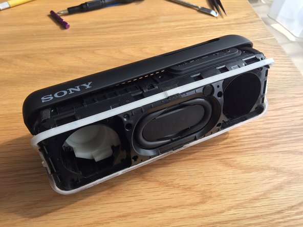

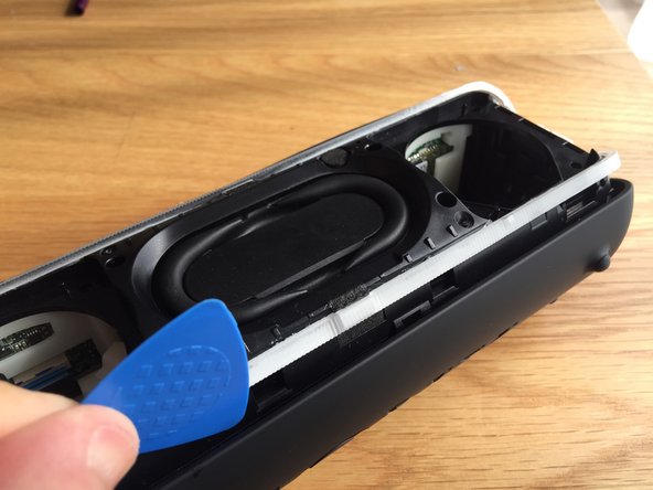

  4. SRS-XB22 Battery Replacement, Removing the outer case.: crwdns2935265:04crwdnd2935265:01crwdnd2935265:03crwdne2935265:0 SRS-XB22 Battery Replacement, Removing the outer case.: crwdns2935265:04crwdnd2935265:02crwdnd2935265:03crwdne2935265:0 SRS-XB22 Battery Replacement, Removing the outer case.: crwdns2935265:04crwdnd2935265:03crwdnd2935265:03crwdne2935265:0
    • Starting at the ends of the speaker, prise the back case away from the main unit.
    • Work your way along the front of the case.
    • Once the front in freed, work you way along the edges, freeing the whole case.
    • There is A LOT of double sided tape between the outer and inner case. It requires a lot of work to remove it.
    • The case is one piece. Although it looks as if it splits at the rear, it is sealed together.

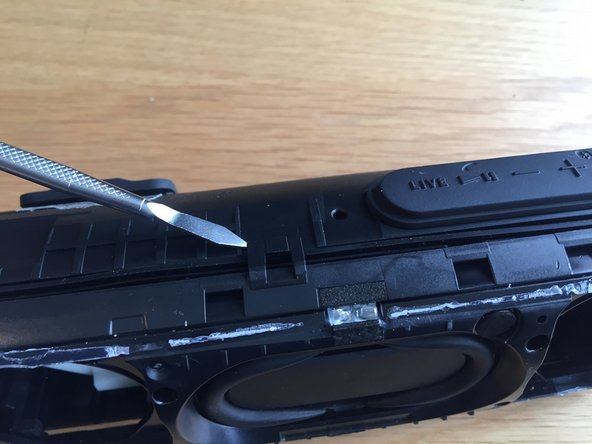

  6. SRS-XB22 Battery Replacement, Remove the front cover: crwdns2935265:06crwdnd2935265:01crwdnd2935265:03crwdne2935265:0 SRS-XB22 Battery Replacement, Remove the front cover: crwdns2935265:06crwdnd2935265:02crwdnd2935265:03crwdne2935265:0 SRS-XB22 Battery Replacement, Remove the front cover: crwdns2935265:06crwdnd2935265:03crwdnd2935265:03crwdne2935265:0
    • Remove 3 screws at either end of the speaker, so 6 screws in total.
    • Using a spudger, unclip the top and bottom plastic clips, holding the front of the speaker.
    • (I made the error and removed the illuminated surround, hence it is not in two of my pictures here - it is NOT necessary to remove it)

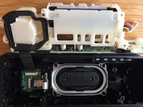

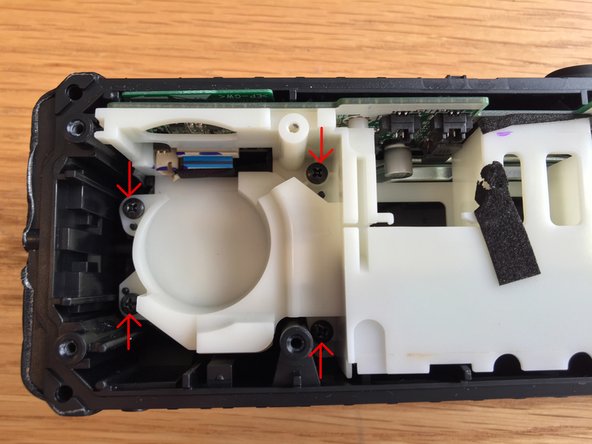

  8. SRS-XB22 Battery Replacement, Freeing the internal components: crwdns2935265:08crwdnd2935265:01crwdnd2935265:03crwdne2935265:0 SRS-XB22 Battery Replacement, Freeing the internal components: crwdns2935265:08crwdnd2935265:02crwdnd2935265:03crwdne2935265:0 SRS-XB22 Battery Replacement, Freeing the internal components: crwdns2935265:08crwdnd2935265:03crwdnd2935265:03crwdne2935265:0
    • Lift the rubber gasket away from the unit.
    • Locate the 6 screws holding the internal structure in place.
    • Remove these 6 screws.

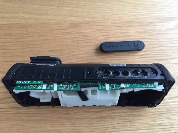

  9. SRS-XB22 Battery Replacement: crwdns2935265:09crwdnd2935265:01crwdnd2935265:03crwdne2935265:0 SRS-XB22 Battery Replacement: crwdns2935265:09crwdnd2935265:02crwdnd2935265:03crwdne2935265:0 SRS-XB22 Battery Replacement: crwdns2935265:09crwdnd2935265:03crwdnd2935265:03crwdne2935265:0
    • Use a spudger to lift the button away from the speaker.
    • Be careful, it's held down by more sticky tape!
