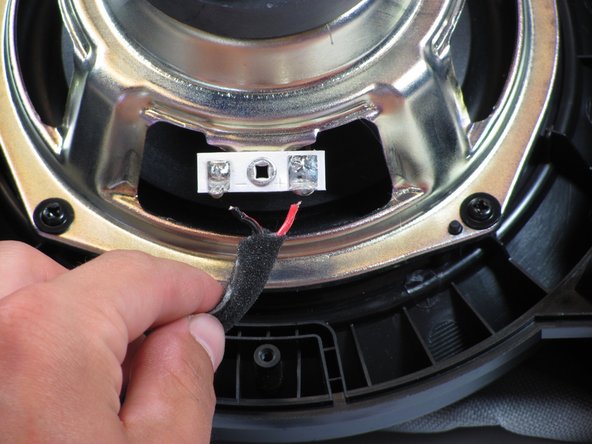

    • Desolder the two connector wires off the bottom plate on the speaker.
    • Note where each cable connects.

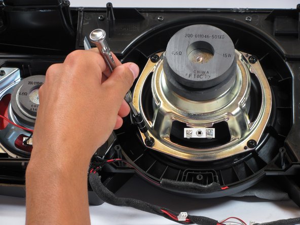

  14. SONY ZS-BTG900 Subwoofer Replacement: crwdns2935265:014crwdnd2935265:01crwdnd2935265:02crwdne2935265:0 SONY ZS-BTG900 Subwoofer Replacement: crwdns2935265:014crwdnd2935265:02crwdnd2935265:02crwdne2935265:0
    • Remove the four 1/2 inch screws using a #2 Phillips screwdriver.

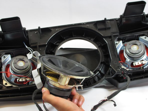

  15. SONY ZS-BTG900 Subwoofer Replacement: crwdns2935265:015crwdnd2935265:01crwdnd2935265:02crwdne2935265:0 SONY ZS-BTG900 Subwoofer Replacement: crwdns2935265:015crwdnd2935265:02crwdnd2935265:02crwdne2935265:0
    • Firmly grab the end of the subwoofer.
    • Pull up and out to remove it.
