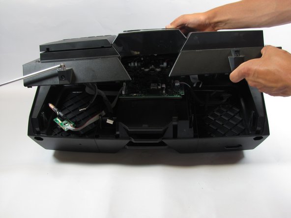

  5. SONY ZS-BTG900 Speaker Replacement: crwdns2935265:05crwdnd2935265:01crwdnd2935265:02crwdne2935265:0 SONY ZS-BTG900 Speaker Replacement: crwdns2935265:05crwdnd2935265:02crwdnd2935265:02crwdne2935265:0
    • Lift off the top, beginning from the back of the device.
    • Take care when lifting the top portion as there are many wires connected to the inside of the device and you do not want to disconnect these just yet.

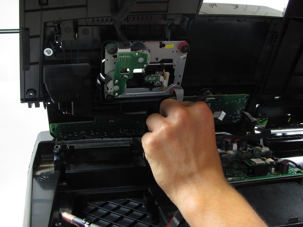

  6. SONY ZS-BTG900 Speaker Replacement: crwdns2935265:06crwdnd2935265:01crwdnd2935265:02crwdne2935265:0 SONY ZS-BTG900 Speaker Replacement: crwdns2935265:06crwdnd2935265:02crwdnd2935265:02crwdne2935265:0
    • Disconnect the CD drive ribbon cable from the top of the device.

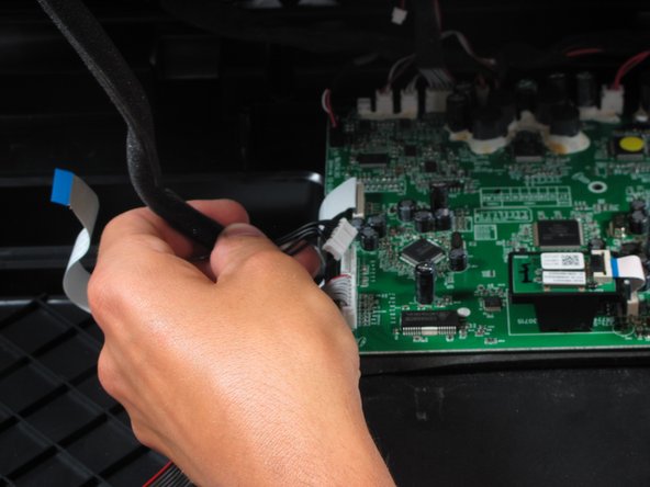

  8. SONY ZS-BTG900 Speaker Replacement: crwdns2935265:08crwdnd2935265:01crwdnd2935265:03crwdne2935265:0 SONY ZS-BTG900 Speaker Replacement: crwdns2935265:08crwdnd2935265:02crwdnd2935265:03crwdne2935265:0 SONY ZS-BTG900 Speaker Replacement: crwdns2935265:08crwdnd2935265:03crwdnd2935265:03crwdne2935265:0
    • Disconnect the remaining cables from the motherboard.

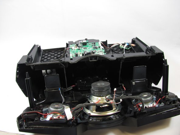

  12. SONY ZS-BTG900 Speaker Replacement, Speaker: crwdns2935265:012crwdnd2935265:01crwdnd2935265:01crwdne2935265:0
    • This guide will be for the two speakers seen on the left and right of the image.

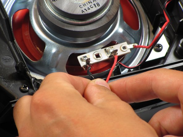

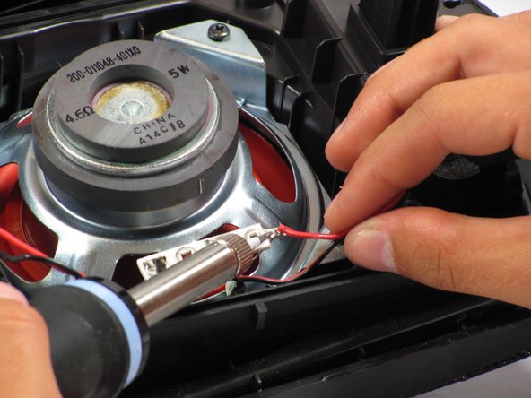

  13. SONY ZS-BTG900 Speaker Replacement: crwdns2935265:013crwdnd2935265:01crwdnd2935265:03crwdne2935265:0 SONY ZS-BTG900 Speaker Replacement: crwdns2935265:013crwdnd2935265:02crwdnd2935265:03crwdne2935265:0 SONY ZS-BTG900 Speaker Replacement: crwdns2935265:013crwdnd2935265:03crwdnd2935265:03crwdne2935265:0
    • Begin by desoldering the connector wires off the metal plate at the bottom of the speaker.
    • Be sure to note where each wire will be resoldered when you have your new speaker in place.
