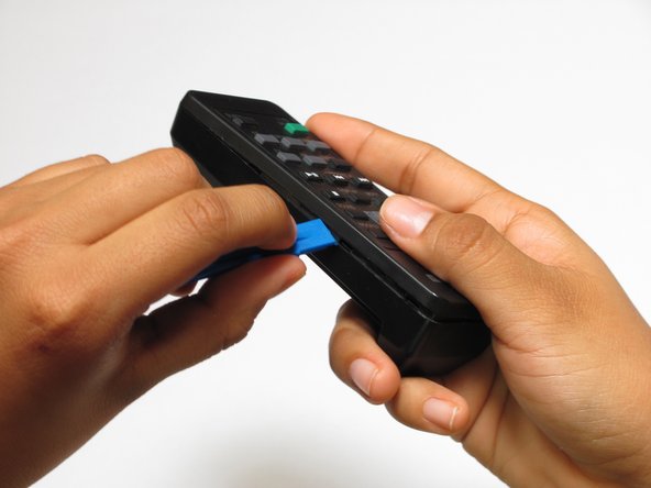

  3. SONY ZS-BTG900 Remote Motherboard Replacement: crwdns2935265:03crwdnd2935265:01crwdnd2935265:02crwdne2935265:0 SONY ZS-BTG900 Remote Motherboard Replacement: crwdns2935265:03crwdnd2935265:02crwdnd2935265:02crwdne2935265:0
    • Use the plastic opening tool along the seam on the side of the remote until you hear a click. This means that the plastic tabs holding the remote together are coming loose.
    • Do this until the top half of the remote comes loose.

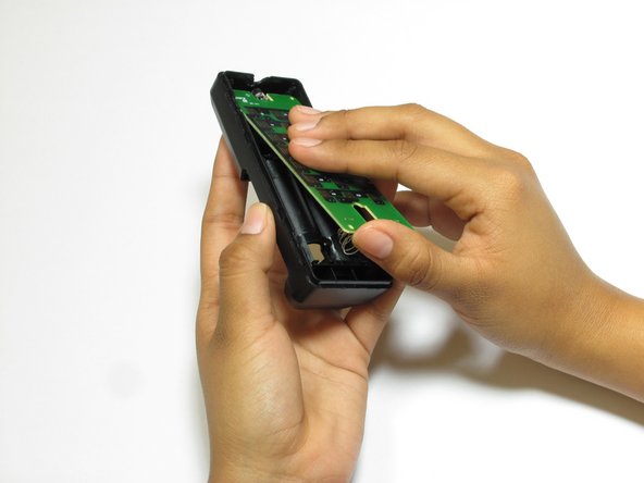

  5. SONY ZS-BTG900 Remote Motherboard Replacement: crwdns2935265:05crwdnd2935265:01crwdnd2935265:02crwdne2935265:0 SONY ZS-BTG900 Remote Motherboard Replacement: crwdns2935265:05crwdnd2935265:02crwdnd2935265:02crwdne2935265:0
    • Lift the chip out of the plastic casing to replace it.
