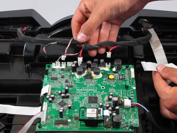

    • Gently pull the corresponding cables individually from the top of the motherboard to remove them.
    • For the next 3 steps, use the plastic prying tool if needed.
  13. SONY ZS-BTG900 Motherboard Replacement: crwdns2935265:013crwdnd2935265:01crwdnd2935265:03crwdne2935265:0 SONY ZS-BTG900 Motherboard Replacement: crwdns2935265:013crwdnd2935265:02crwdnd2935265:03crwdne2935265:0 SONY ZS-BTG900 Motherboard Replacement: crwdns2935265:013crwdnd2935265:03crwdnd2935265:03crwdne2935265:0

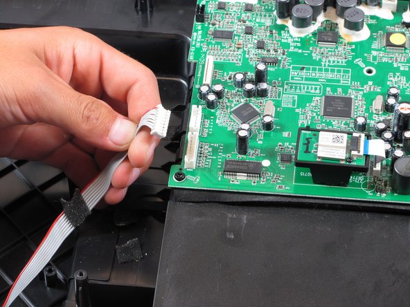

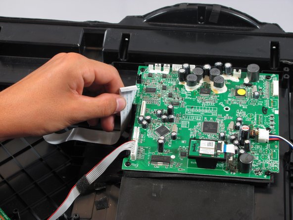

    • Remove the following 2 cables from the left side of the board.
  14. SONY ZS-BTG900 Motherboard Replacement: crwdns2935265:014crwdnd2935265:01crwdnd2935265:01crwdne2935265:0
    • Remove the final cable on the bottom right side of the motherboard.
