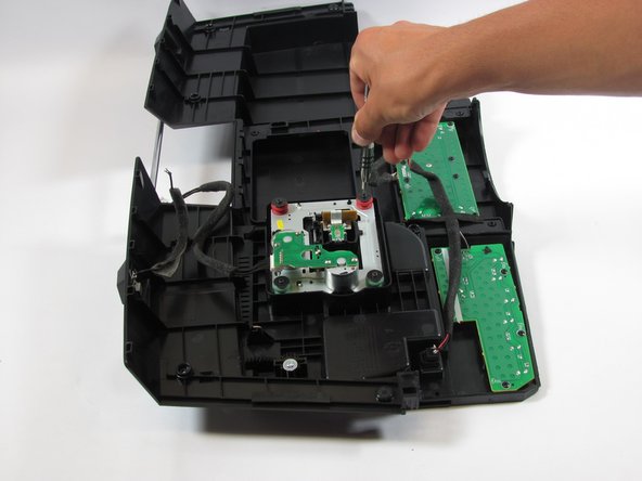

  12. SONY ZS-BTG900 CD Player Drive Replacement, CD Player Drive: crwdns2935265:012crwdnd2935265:01crwdnd2935265:01crwdne2935265:0
    • Flip the top and locate the CD module on the right side.
  13. SONY ZS-BTG900 CD Player Drive Replacement: crwdns2935265:013crwdnd2935265:01crwdnd2935265:02crwdne2935265:0 SONY ZS-BTG900 CD Player Drive Replacement: crwdns2935265:013crwdnd2935265:02crwdnd2935265:02crwdne2935265:0
    • Use a Phillips #2 screwdriver to unscrew the four 1/2 inch screws.
  14. SONY ZS-BTG900 CD Player Drive Replacement: crwdns2935265:014crwdnd2935265:01crwdnd2935265:02crwdne2935265:0 SONY ZS-BTG900 CD Player Drive Replacement: crwdns2935265:014crwdnd2935265:02crwdnd2935265:02crwdne2935265:0
    • Firmly grab and lift the CD drive from its plastic compartment to remove it.
