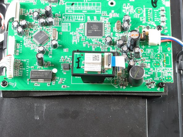

  12. SONY ZS-BTG900 Bluetooth Module Replacement, Bluetooth Module: crwdns2935265:012crwdnd2935265:01crwdnd2935265:03crwdne2935265:0 SONY ZS-BTG900 Bluetooth Module Replacement, Bluetooth Module: crwdns2935265:012crwdnd2935265:02crwdnd2935265:03crwdne2935265:0 SONY ZS-BTG900 Bluetooth Module Replacement, Bluetooth Module: crwdns2935265:012crwdnd2935265:03crwdnd2935265:03crwdne2935265:0

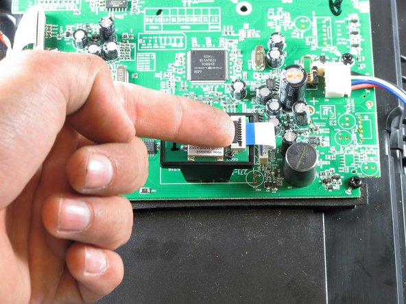

    • Lift the plastic tab on the ribbon cable on the bluetooth module using the spudger.

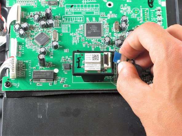

  13. SONY ZS-BTG900 Bluetooth Module Replacement: crwdns2935265:013crwdnd2935265:01crwdnd2935265:02crwdne2935265:0 SONY ZS-BTG900 Bluetooth Module Replacement: crwdns2935265:013crwdnd2935265:02crwdnd2935265:02crwdne2935265:0
    • Pull the ribbon cable out to remove it.

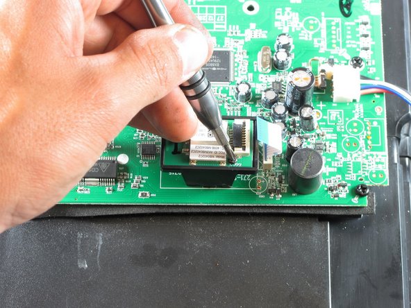

    • Use a Phillips #0 screwdriver to unscrew the single 1/4 inch screw.
  15. SONY ZS-BTG900 Bluetooth Module Replacement: crwdns2935265:015crwdnd2935265:01crwdnd2935265:03crwdne2935265:0 SONY ZS-BTG900 Bluetooth Module Replacement: crwdns2935265:015crwdnd2935265:02crwdnd2935265:03crwdne2935265:0 SONY ZS-BTG900 Bluetooth Module Replacement: crwdns2935265:015crwdnd2935265:03crwdnd2935265:03crwdne2935265:0
