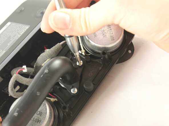

  6. SONY SRS-X2 Speaker Replacement: crwdns2935265:06crwdnd2935265:01crwdnd2935265:02crwdne2935265:0 SONY SRS-X2 Speaker Replacement: crwdns2935265:06crwdnd2935265:02crwdnd2935265:02crwdne2935265:0
    • Remove the four, 10 mm Phillips#1 screws from the black pipe. This allows for air to flow through the device to the battery to cool it, but it is in the way of removing the speaker.
    • Once the screws have been taken out just lift the pipe up and away from the device components.
