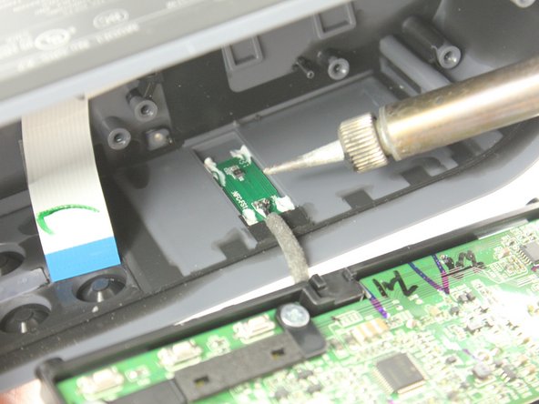

  7. SONY SRS-X2 Motherboard Replacement, Motherboard: crwdns2935265:07crwdnd2935265:01crwdnd2935265:01crwdne2935265:0
    • Use PH1 screwdriver to remove three 11mm Phillips head screws that are holding the motherboard together.
  8. SONY SRS-X2 Motherboard Replacement: crwdns2935265:08crwdnd2935265:01crwdnd2935265:01crwdne2935265:0
    • Gently use your fingers to pull out the white ribbon.
  9. SONY SRS-X2 Motherboard Replacement: crwdns2935265:09crwdnd2935265:01crwdnd2935265:02crwdne2935265:0 SONY SRS-X2 Motherboard Replacement: crwdns2935265:09crwdnd2935265:02crwdnd2935265:02crwdne2935265:0
    • Pull the motherboard out of the speaker slowly, gently flip it upside down to find the wire that soldered to the ceiling of the speaker.
    • Use a hot soldering iron and detach the wire.
    • Once the motherboard is disconnected, it can be removed for replacement.
