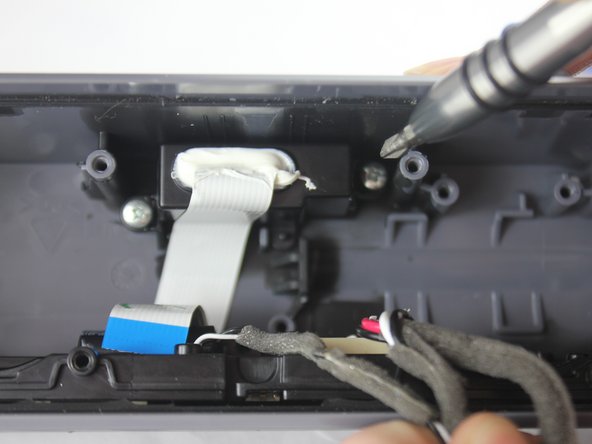

  3. SONY SRS-X2 Charger Port Replacement: crwdns2935265:03crwdnd2935265:01crwdnd2935265:02crwdne2935265:0 SONY SRS-X2 Charger Port Replacement: crwdns2935265:03crwdnd2935265:02crwdnd2935265:02crwdne2935265:0
    • Before removing the host plate, face the feet of the speaker to you. The wiring allows for minimal access to the inner components.
    • Use the spudger to remove the speaker host plate. Insert the metal tip in the seam between the host plate and the shell.
    • Be very careful when pulling the speaker host plate (described in the next step) as there are wiring connected to the host plate. This wiring is soldered to the plate and to the shell of the device. The wires are flexible and you can still open the device as shown in the second picture.
    • Center the spudger on the top of the device, this is furthest from the wiring, in wiggling the spudger under the plate, the plate should move up and out of the shell, you can finish lifting the plate away with your fingers.

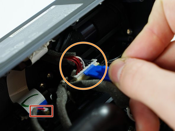

  4. SONY SRS-X2 Charger Port Replacement: crwdns2935265:04crwdnd2935265:01crwdnd2935265:02crwdne2935265:0 SONY SRS-X2 Charger Port Replacement: crwdns2935265:04crwdnd2935265:02crwdnd2935265:02crwdne2935265:0
    • Be gentle when using the opening tool, wiggle the opening tool on each side of the socket to be sure the plastic does not snap.
    • Be careful not to damage the wires, pull from the plastic base to unplug.
    • Unplug the power cable connector shown using the plastic opening tool. Wiggle the tool under the lip of the plug, the smaller area and odd angle means lifting up with the plastic tool in the setup shown.
    • Unplug the power connector shown in the second image. Using the plastic opening tool lift from the front of the plug and move the opening tool to either side to get it all the way out of the socket.

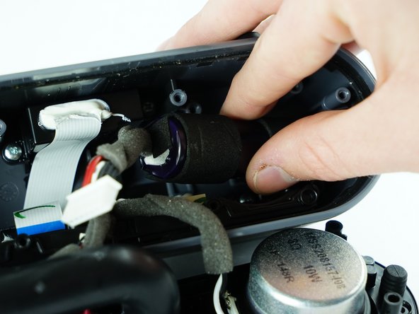

  5. SONY SRS-X2 Charger Port Replacement, Battery: crwdns2935265:05crwdnd2935265:01crwdnd2935265:02crwdne2935265:0 SONY SRS-X2 Charger Port Replacement, Battery: crwdns2935265:05crwdnd2935265:02crwdnd2935265:02crwdne2935265:0
    • Remove the four, 11 mm, Phillips#1 screws on the battery cover plate.
  6. SONY SRS-X2 Charger Port Replacement: crwdns2935265:06crwdnd2935265:01crwdnd2935265:02crwdne2935265:0 SONY SRS-X2 Charger Port Replacement: crwdns2935265:06crwdnd2935265:02crwdnd2935265:02crwdne2935265:0
    • Remove the battery cover plate carefully then proceed to remove the battery.
  7. SONY SRS-X2 Charger Port Replacement, Charger Port: crwdns2935265:07crwdnd2935265:01crwdnd2935265:02crwdne2935265:0 SONY SRS-X2 Charger Port Replacement, Charger Port: crwdns2935265:07crwdnd2935265:02crwdnd2935265:02crwdne2935265:0
    • Use PH1 screwdriver to remove two 11mm Phillips #1 screws on the charger port.
    • Gently pull out the charger port with fingers for replacement.
