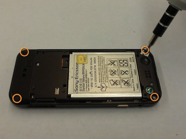

  4. SONY Ericsson W890i Keypad and Front Cover Replacement, Keypad and Front Cover: crwdns2935265:04crwdnd2935265:01crwdnd2935265:02crwdne2935265:0 SONY Ericsson W890i Keypad and Front Cover Replacement, Keypad and Front Cover: crwdns2935265:04crwdnd2935265:02crwdnd2935265:02crwdne2935265:0
    • Remove the two small rubber pieces that cover the lower screws.
    • Using a T-6 Torx wrench or screwdriver, remove all four of the small screws at the top and bottom corners on the back of the phones.
