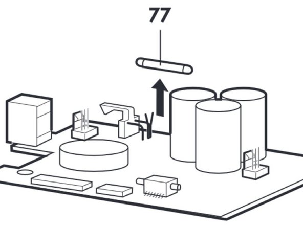

  10. SOMNOcomfort and SOMNObalance Ventilator Fuse Replacement, Fuse: crwdns2935265:010crwdnd2935265:01crwdnd2935265:01crwdne2935265:0
    • Open the unit (refer to the guide "How to Open and Close Housing")
  11. SOMNOcomfort and SOMNObalance Ventilator Fuse Replacement: crwdns2935265:011crwdnd2935265:01crwdnd2935265:02crwdne2935265:0 SOMNOcomfort and SOMNObalance Ventilator Fuse Replacement: crwdns2935265:011crwdnd2935265:02crwdnd2935265:02crwdne2935265:0
    • Remove the defective fuse(76 or 77) and replace with a new one. (pg. 27)
    • Ensure the correct amperage is used. Use fuses mentioned in the Replacement parts list only. Using other fuses may cause damage to the main circuit board.
    • 76 refers to the fuse in SOMNObalance. 77 refers to the fuse in SOMNOcomfort.
  12. SOMNOcomfort and SOMNObalance Ventilator Fuse Replacement: crwdns2935265:012crwdnd2935265:01crwdnd2935265:01crwdne2935265:0
    • Close the Unit (refer to the guide "How to Open and Close Housing").
Check that everything is working properly after having successfully replaced the fuse.
