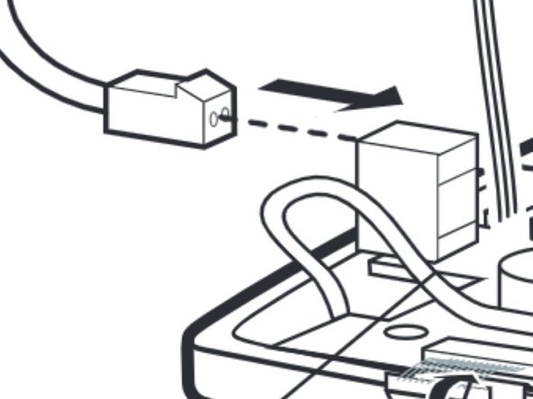

    • Remove the connector (X1) from the circuit board.
    • Pull the connecting cable (64) from its mount.
    • Now set aside the lower part of the housing. (pg. 23)

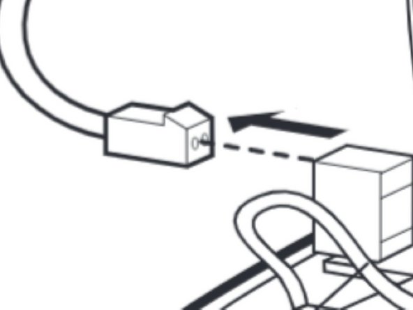

    • Hold the lower part of the housing to the upper part at an angle
    • Attach the connector (X1) to the main circuit board. When doing so the connector’s nub has to point towards the lock. (pg. 24)

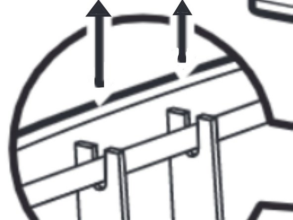

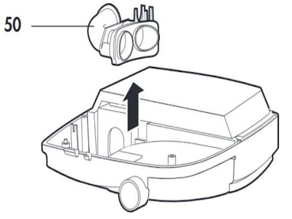

  11. SOMNOcomfort and SOMNObalance Ventilator Fan Replacement: crwdns2935265:011crwdnd2935265:01crwdnd2935265:02crwdne2935265:0 SOMNOcomfort and SOMNObalance Ventilator Fan Replacement: crwdns2935265:011crwdnd2935265:02crwdnd2935265:02crwdne2935265:0
    • Remove the decoupling tube(50) from the box.

    • Apply a small amount of 70% Isopropanol solution on the decoupling tube’s (50) circumference and attach it to the box. The tube’s notch must completely lock into the bore hole rim.
