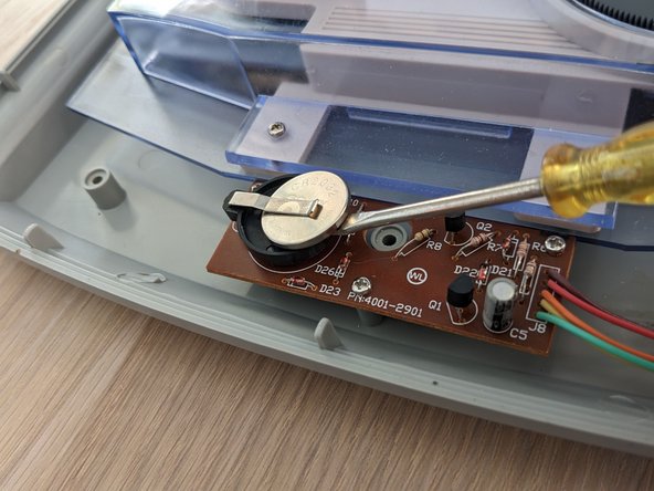

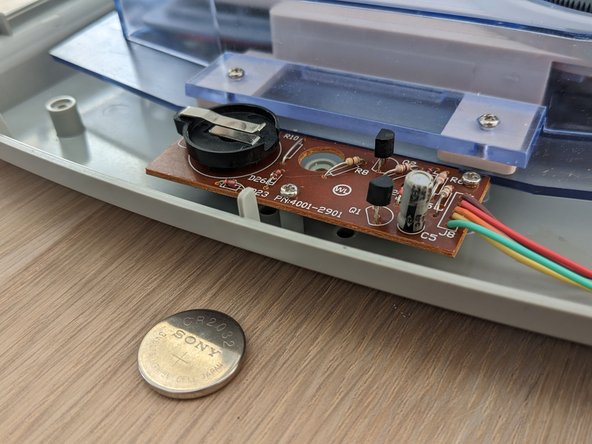

  4. SN Programmable (SV-336) Battery Replacement: crwdns2935265:04crwdnd2935265:01crwdnd2935265:03crwdne2935265:0 SN Programmable (SV-336) Battery Replacement: crwdns2935265:04crwdnd2935265:02crwdnd2935265:03crwdne2935265:0 SN Programmable (SV-336) Battery Replacement: crwdns2935265:04crwdnd2935265:03crwdnd2935265:03crwdne2935265:0
    • The CR2032 battery is in a holder in a separate circuit board at the front edge of the controller. Use a small flat-head screwdriver to lever it upwards, then slide it out of its holder to the right.
    • Slide the replacement battery in.
