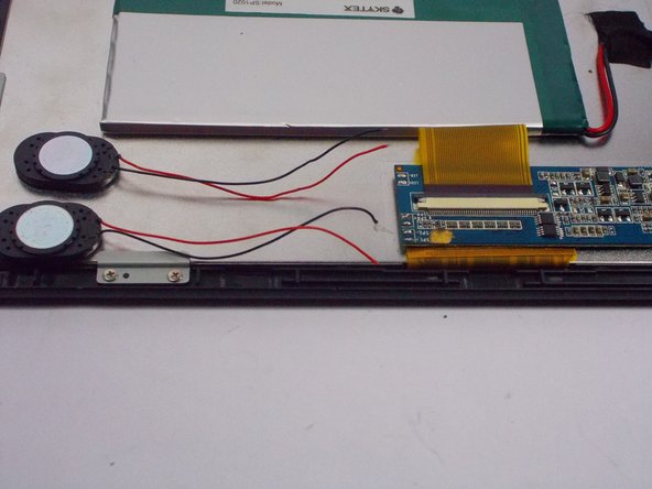

  8. SKYTEX SP1020 Motherboard Replacement, Speakers: crwdns2935265:08crwdnd2935265:01crwdnd2935265:01crwdne2935265:0
    • locate the speakers
  9. SKYTEX SP1020 Motherboard Replacement: crwdns2935265:09crwdnd2935265:01crwdnd2935265:02crwdne2935265:0 SKYTEX SP1020 Motherboard Replacement: crwdns2935265:09crwdnd2935265:02crwdnd2935265:02crwdne2935265:0
    • Use a soldering iron and desoldering braid to desolder the two sets of red and black wires.
  10. SKYTEX SP1020 Motherboard Replacement: crwdns2935265:010crwdnd2935265:01crwdnd2935265:01crwdne2935265:0
    • Use a plastic opening tool to pry the speakers out of the rear case.

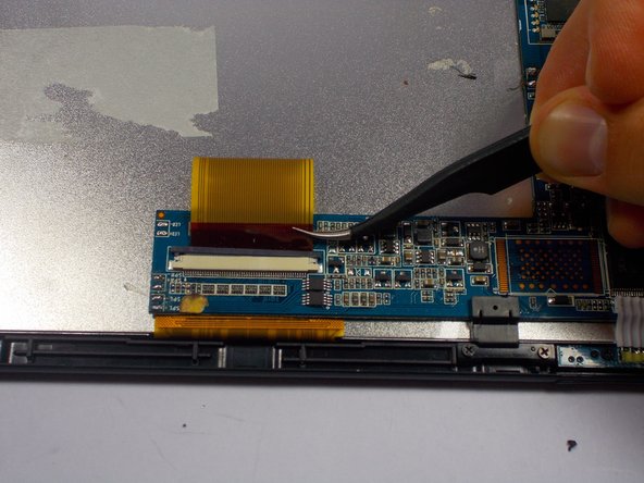

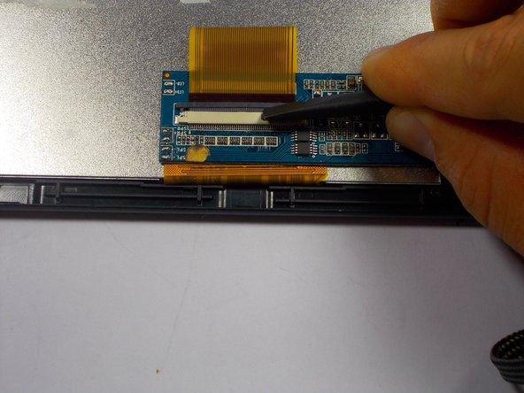

  12. SKYTEX SP1020 Motherboard Replacement: crwdns2935265:012crwdnd2935265:01crwdnd2935265:03crwdne2935265:0 SKYTEX SP1020 Motherboard Replacement: crwdns2935265:012crwdnd2935265:02crwdnd2935265:03crwdne2935265:0 SKYTEX SP1020 Motherboard Replacement: crwdns2935265:012crwdnd2935265:03crwdnd2935265:03crwdne2935265:0
    • Locate the two ribbon cables that will need to be removed.
    • Using the spudger tool, slide the black clip over the white housing up. This will release the ribbon cable.
    • Once the ribbon cable is loose, the tweezers should be used to slide the cable out.
    • Don't grab the ribbon cable too hard, to avoid any damage to the cable.

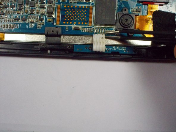

  13. SKYTEX SP1020 Motherboard Replacement: crwdns2935265:013crwdnd2935265:01crwdnd2935265:02crwdne2935265:0 SKYTEX SP1020 Motherboard Replacement: crwdns2935265:013crwdnd2935265:02crwdnd2935265:02crwdne2935265:0
    • Locate the set of wires with a white coating located at the bottom of the motherboard.
    • Using the tweezers carefully remove the cables one at a time from the motherboard.
    • Avoid any damage to the tips of the wires.
