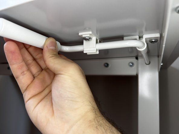

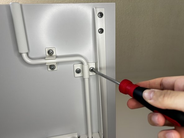

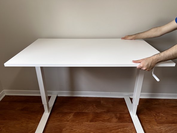

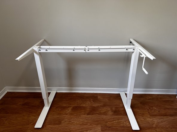

    • Remove the height adjustment crank by pulling it down and out from its clip.
    • Do not turn the crank at any point during the process to avoid an alignment issue.

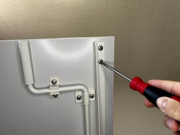

  2. SKARSTA Desk O-ring Replacement: crwdns2935265:02crwdnd2935265:01crwdnd2935265:03crwdne2935265:0 SKARSTA Desk O-ring Replacement: crwdns2935265:02crwdnd2935265:02crwdnd2935265:03crwdne2935265:0 SKARSTA Desk O-ring Replacement: crwdns2935265:02crwdnd2935265:03crwdnd2935265:03crwdne2935265:0
    • Position yourself so you can comfortably reach underneath the desk. This might involve kneeling or sitting next to/under the desk.

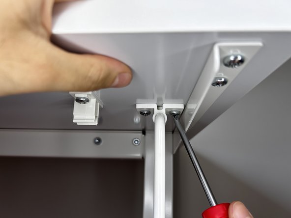

    • Remove the two 15.2 mm Phillips #2 screws connecting the crank to the table.
    • Remove the eight 15.2 mm Phillips #2 screws connecting the table to the legs.
    • Do not use a power tool to screw/unscrew the screws, as it may crack the desk.

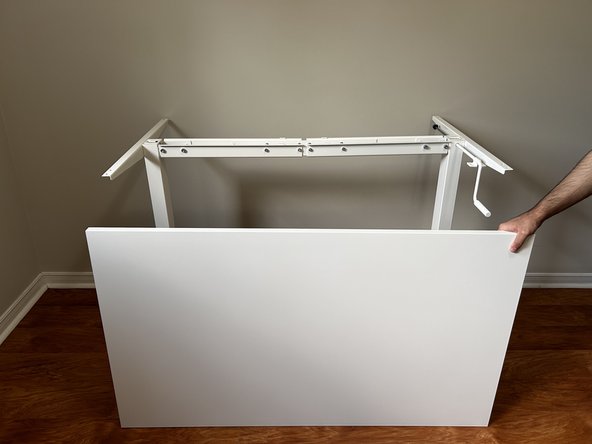

  3. SKARSTA Desk O-ring Replacement: crwdns2935265:03crwdnd2935265:01crwdnd2935265:03crwdne2935265:0 SKARSTA Desk O-ring Replacement: crwdns2935265:03crwdnd2935265:02crwdnd2935265:03crwdne2935265:0 SKARSTA Desk O-ring Replacement: crwdns2935265:03crwdnd2935265:03crwdnd2935265:03crwdne2935265:0
    • Carefully lift the table off the stand and set it aside.
    • Ask for help if needed to avoid accidentally damaging the desk or if it is too heavy for you.

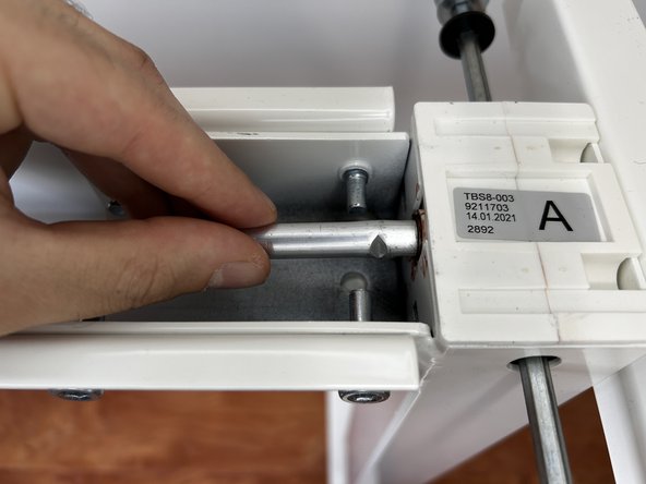

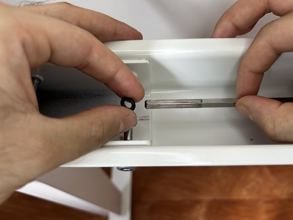

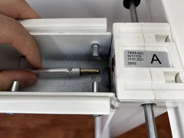

  4. SKARSTA Desk O-ring Replacement: crwdns2935265:04crwdnd2935265:01crwdnd2935265:03crwdne2935265:0 SKARSTA Desk O-ring Replacement: crwdns2935265:04crwdnd2935265:02crwdnd2935265:03crwdne2935265:0 SKARSTA Desk O-ring Replacement: crwdns2935265:04crwdnd2935265:03crwdnd2935265:03crwdne2935265:0

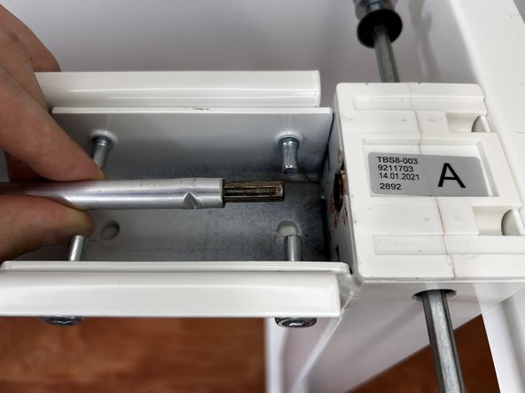

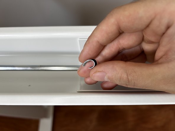

    • Remove the broken O-ring from the adjustment mechanism.
    • The broken O-ring might not be on the rod as shown in the picture but underneath it.

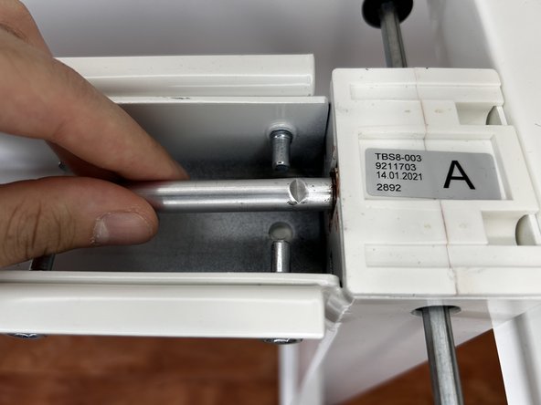

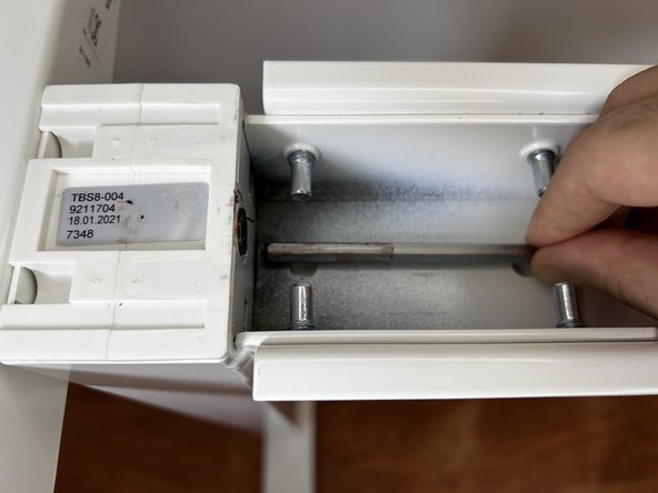

  5. SKARSTA Desk O-ring Replacement: crwdns2935265:05crwdnd2935265:01crwdnd2935265:03crwdne2935265:0 SKARSTA Desk O-ring Replacement: crwdns2935265:05crwdnd2935265:02crwdnd2935265:03crwdne2935265:0 SKARSTA Desk O-ring Replacement: crwdns2935265:05crwdnd2935265:03crwdnd2935265:03crwdne2935265:0
    • Pull the rod out to detach it from the stand.
    • Set the rod down to use at reassembly.

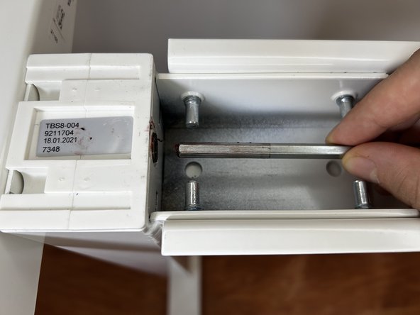

  6. SKARSTA Desk O-ring Replacement: crwdns2935265:06crwdnd2935265:01crwdnd2935265:03crwdne2935265:0 SKARSTA Desk O-ring Replacement: crwdns2935265:06crwdnd2935265:02crwdnd2935265:03crwdne2935265:0 SKARSTA Desk O-ring Replacement: crwdns2935265:06crwdnd2935265:03crwdnd2935265:03crwdne2935265:0
    • Repeat the previous step on the opposite end of the rod.

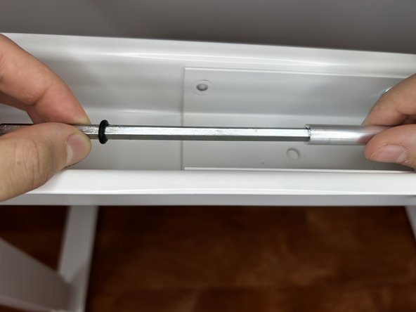

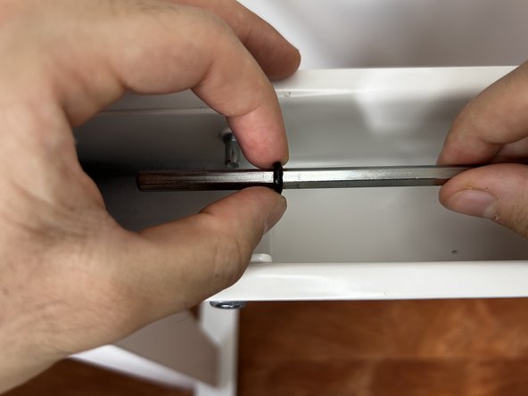

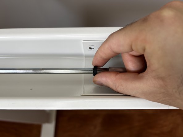

  7. SKARSTA Desk O-ring Replacement: crwdns2935265:07crwdnd2935265:01crwdnd2935265:03crwdne2935265:0 SKARSTA Desk O-ring Replacement: crwdns2935265:07crwdnd2935265:02crwdnd2935265:03crwdne2935265:0 SKARSTA Desk O-ring Replacement: crwdns2935265:07crwdnd2935265:03crwdnd2935265:03crwdne2935265:0
    • Slide the new O-ring over the thin side of the rod.
    • There may be lubricant on the rod; avoid wiping it off.
  8. SKARSTA Desk O-ring Replacement: crwdns2935265:08crwdnd2935265:01crwdnd2935265:03crwdne2935265:0 SKARSTA Desk O-ring Replacement: crwdns2935265:08crwdnd2935265:02crwdnd2935265:03crwdne2935265:0 SKARSTA Desk O-ring Replacement: crwdns2935265:08crwdnd2935265:03crwdnd2935265:03crwdne2935265:0
    • Push the thick end of the rod back into the stand to reattach it.

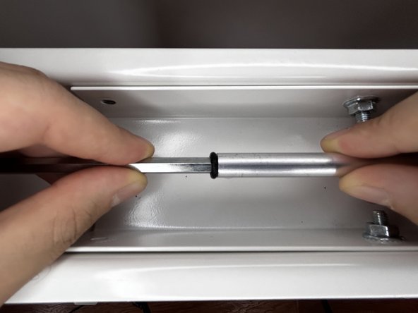

  9. SKARSTA Desk O-ring Replacement: crwdns2935265:09crwdnd2935265:01crwdnd2935265:03crwdne2935265:0 SKARSTA Desk O-ring Replacement: crwdns2935265:09crwdnd2935265:02crwdnd2935265:03crwdne2935265:0 SKARSTA Desk O-ring Replacement: crwdns2935265:09crwdnd2935265:03crwdnd2935265:03crwdne2935265:0
    • Hold the thick end of the rod in place while sliding the thin end outwards.
    • Push the thin end back into the stand while holding the thick end in place.
    • The thick end of the rod might slide out during this process so be sure to hold it in place when sliding and attaching the thin end.

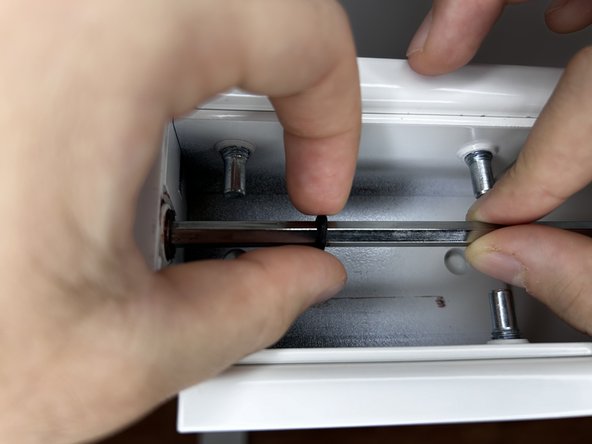

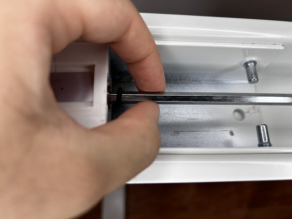

  10. SKARSTA Desk O-ring Replacement: crwdns2935265:010crwdnd2935265:01crwdnd2935265:03crwdne2935265:0 SKARSTA Desk O-ring Replacement: crwdns2935265:010crwdnd2935265:02crwdnd2935265:03crwdne2935265:0 SKARSTA Desk O-ring Replacement: crwdns2935265:010crwdnd2935265:03crwdnd2935265:03crwdne2935265:0
    • Slide the O-ring towards the thicker end of the rod.
    • Pull the thick and thin ends apart and push the O-ring as close to the thick end as possible to secure the rod in place.

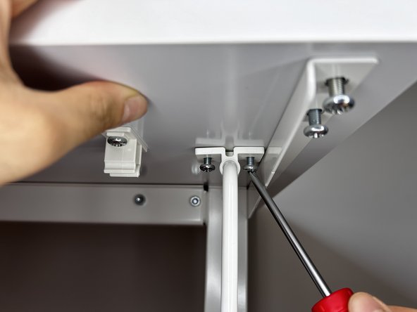

  12. SKARSTA Desk O-ring Replacement: crwdns2935265:012crwdnd2935265:01crwdnd2935265:03crwdne2935265:0 SKARSTA Desk O-ring Replacement: crwdns2935265:012crwdnd2935265:02crwdnd2935265:03crwdne2935265:0 SKARSTA Desk O-ring Replacement: crwdns2935265:012crwdnd2935265:03crwdnd2935265:03crwdne2935265:0
    • Use a Phillips #2 screwdriver to replace the eight 15.2 mm screws securing the table to the stand.
    • Turn all the screws halfway first, then tighten them completely.
    • Use a Phillips #2 screwdriver to replace the two 15.2 mm screws that secure the hand crank.
    • Make sure the handle is facing the correct direction before replacing the screws.
  13. SKARSTA Desk O-ring Replacement: crwdns2935265:013crwdnd2935265:01crwdnd2935265:03crwdne2935265:0 SKARSTA Desk O-ring Replacement: crwdns2935265:013crwdnd2935265:02crwdnd2935265:03crwdne2935265:0 SKARSTA Desk O-ring Replacement: crwdns2935265:013crwdnd2935265:03crwdnd2935265:03crwdne2935265:0
    • Rotate the crank inward to the clip until it clicks into place.
