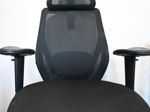

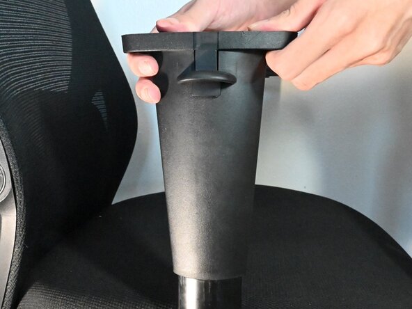

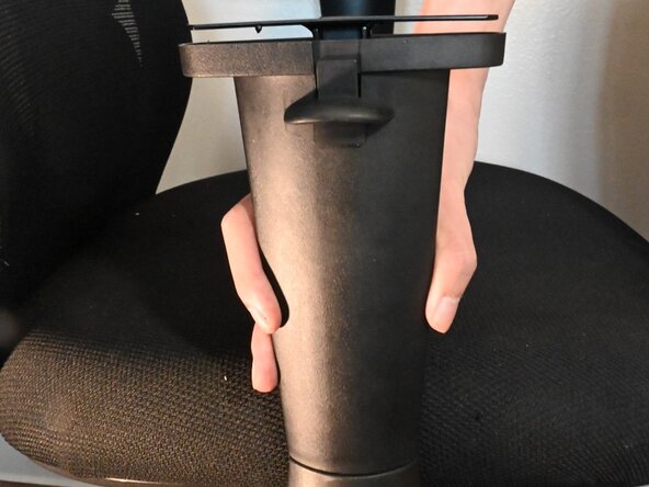

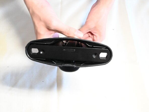

    • Using your hands, pull the armrest upwards to remove it from the chair.
    • Hold both ends of the arm pad to ensure a secure grip before pulling with moderate force.
    • This will work best when the armrest is set at the highest adjustment.

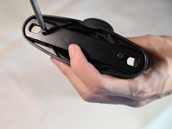

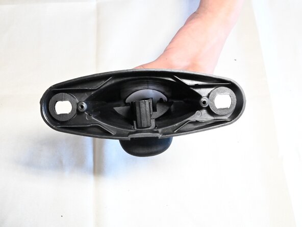

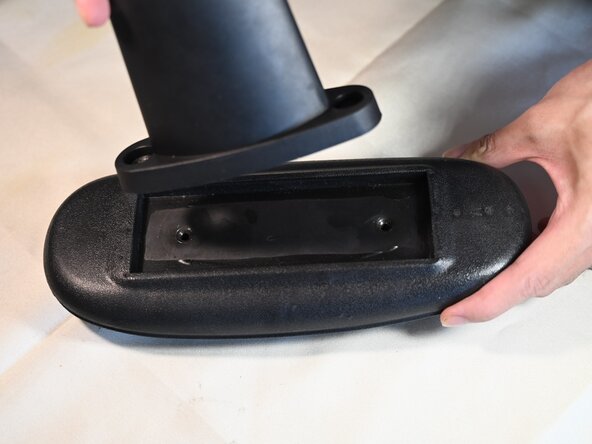

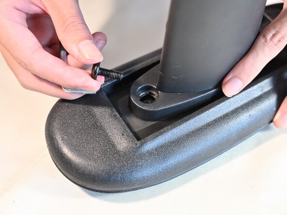

    • Place the armrest upside down on a table.
    • Use an Allen wrench to remove the two 5 mm hex screws by turning counterclockwise.
    • Remove the arm shaft from the arm pad.

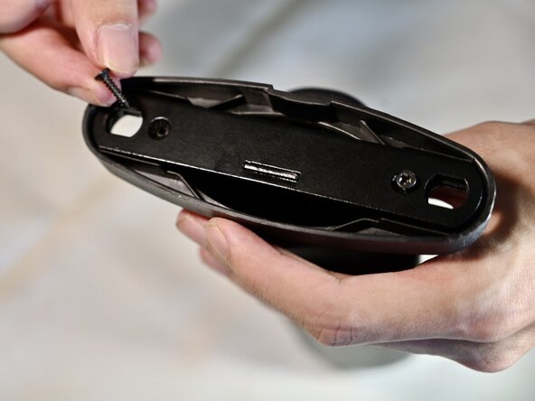

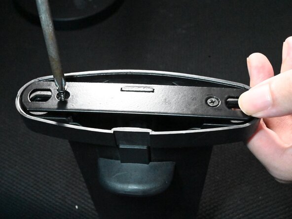

  3. SIHOO M57 Ergonomic Office Chair Armrest Tension Spring Replacement: crwdns2935265:03crwdnd2935265:01crwdnd2935265:03crwdne2935265:0 SIHOO M57 Ergonomic Office Chair Armrest Tension Spring Replacement: crwdns2935265:03crwdnd2935265:02crwdnd2935265:03crwdne2935265:0 SIHOO M57 Ergonomic Office Chair Armrest Tension Spring Replacement: crwdns2935265:03crwdnd2935265:03crwdnd2935265:03crwdne2935265:0
    • Use a Phillips #1 screwdriver to remove the two 2 mm Phillips screws securing the parts of the adjustment mechanism.
    • Be careful when removing the screws here. Some parts may slip down from underneath as parts loosen.

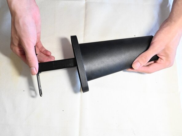

  4. SIHOO M57 Ergonomic Office Chair Armrest Tension Spring Replacement: crwdns2935265:04crwdnd2935265:01crwdnd2935265:02crwdne2935265:0 SIHOO M57 Ergonomic Office Chair Armrest Tension Spring Replacement: crwdns2935265:04crwdnd2935265:02crwdnd2935265:02crwdne2935265:0

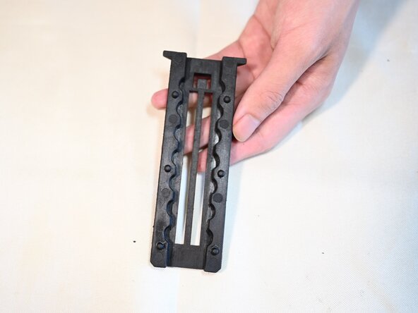

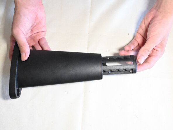

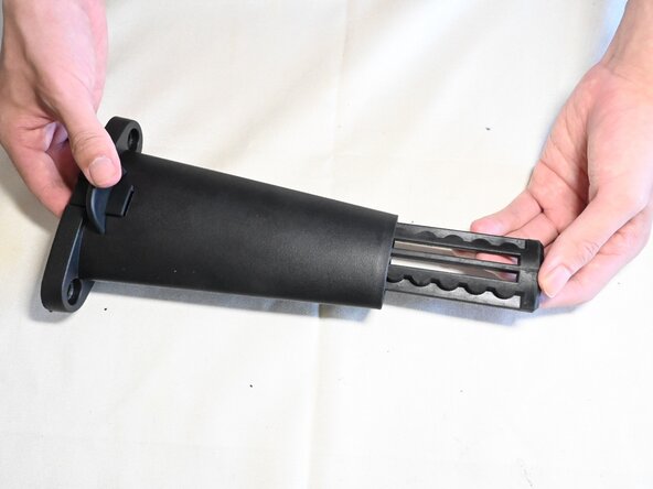

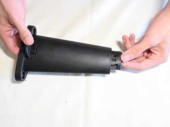

    • Carefully slide the components of the adjustment track out, starting with the hard plastic parts.

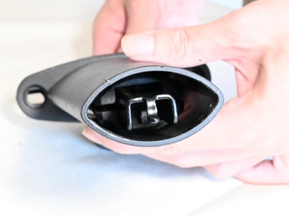

  5. SIHOO M57 Ergonomic Office Chair Armrest Tension Spring Replacement: crwdns2935265:05crwdnd2935265:01crwdnd2935265:03crwdne2935265:0 SIHOO M57 Ergonomic Office Chair Armrest Tension Spring Replacement: crwdns2935265:05crwdnd2935265:02crwdnd2935265:03crwdne2935265:0 SIHOO M57 Ergonomic Office Chair Armrest Tension Spring Replacement: crwdns2935265:05crwdnd2935265:03crwdnd2935265:03crwdne2935265:0

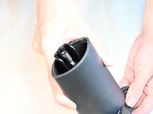

    • Lay out everything for easy access, including the replacement spring.

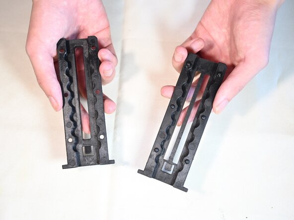

    • Taking the two clasps, choose the one with the bar in the middle.
  6. SIHOO M57 Ergonomic Office Chair Armrest Tension Spring Replacement: crwdns2935265:06crwdnd2935265:01crwdnd2935265:03crwdne2935265:0 SIHOO M57 Ergonomic Office Chair Armrest Tension Spring Replacement: crwdns2935265:06crwdnd2935265:02crwdnd2935265:03crwdne2935265:0 SIHOO M57 Ergonomic Office Chair Armrest Tension Spring Replacement: crwdns2935265:06crwdnd2935265:03crwdnd2935265:03crwdne2935265:0
    • Push the adjustment tab up and insert the clasp piece into the arm shaft from the bottom.
    • Make sure you insert the slightly wider end first.
    • Check to make sure it rests neatly inside.

    • Take the other clasp and insert it into the arm shaft from the bottom.
    • Push the adjustment tab up to ensure a smoother entry.
    • Check to make sure it rests neatly inside with the other parts.

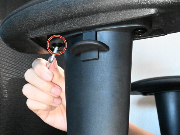

  12. SIHOO M57 Ergonomic Office Chair Armrest Tension Spring Replacement: crwdns2935265:012crwdnd2935265:01crwdnd2935265:03crwdne2935265:0 SIHOO M57 Ergonomic Office Chair Armrest Tension Spring Replacement: crwdns2935265:012crwdnd2935265:02crwdnd2935265:03crwdne2935265:0 SIHOO M57 Ergonomic Office Chair Armrest Tension Spring Replacement: crwdns2935265:012crwdnd2935265:03crwdnd2935265:03crwdne2935265:0
    • Place the arm pad back on.
    • Screw the two 5 mm hex screws back in place using an Allen wrench, rotating clockwise.
