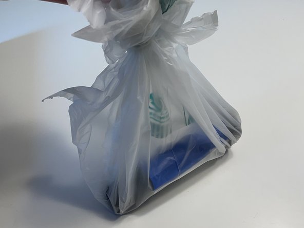

    • To properly store and then dispose of the battery put it in a clear plastic bag.

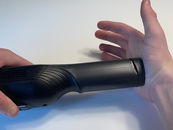

    • Slot your replacement battery where the old one was.
    • Once inside, push hard on the end until you hear a click.
