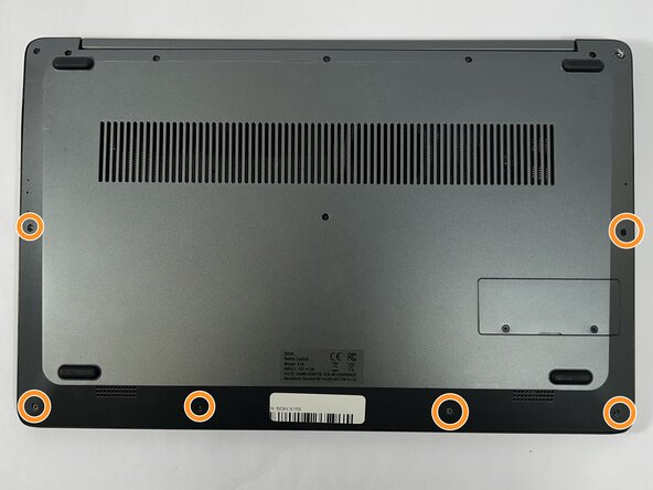

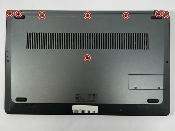

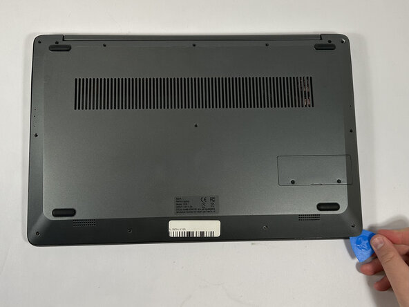

    • Remove the eight top and middle 7.3 mm screws using the Phillips #0 screwdriver.
    • Remove the six bottom and side 4.4 mm screws using the Phillips #0 screwdriver.

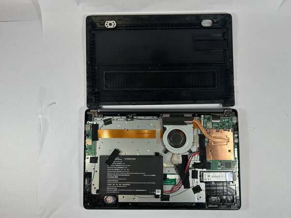

  2. SGIN X15S M.2 SSD Replacement: crwdns2935265:02crwdnd2935265:01crwdnd2935265:03crwdne2935265:0 SGIN X15S M.2 SSD Replacement: crwdns2935265:02crwdnd2935265:02crwdnd2935265:03crwdne2935265:0 SGIN X15S M.2 SSD Replacement: crwdns2935265:02crwdnd2935265:03crwdnd2935265:03crwdne2935265:0
    • Use the nylon spudger to gently pry a bit of the back panel open. With the opening pick, go all the way around until the back panel is loose.
    • Pull the back panel off the laptop.

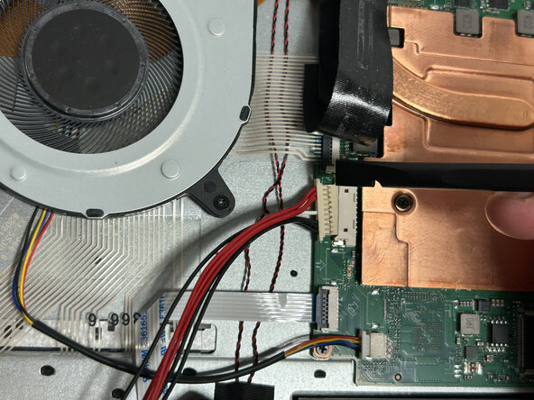

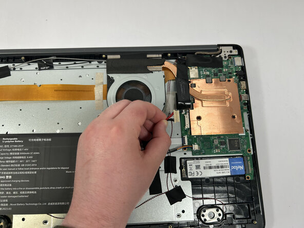

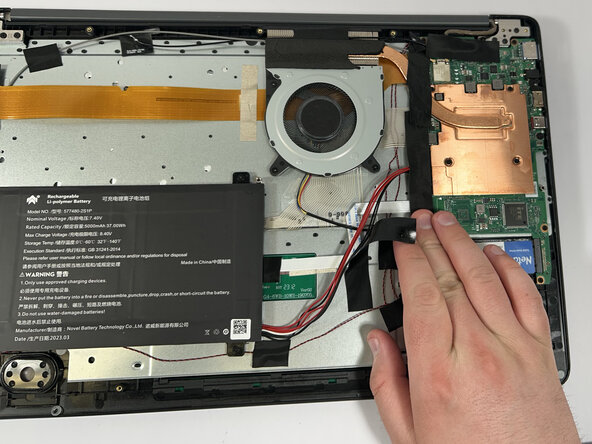

  3. SGIN X15S M.2 SSD Replacement, Unplugging SGIN X15S Battery: crwdns2935265:03crwdnd2935265:01crwdnd2935265:02crwdne2935265:0 SGIN X15S M.2 SSD Replacement, Unplugging SGIN X15S Battery: crwdns2935265:03crwdnd2935265:02crwdnd2935265:02crwdne2935265:0
    • Gently remove the tape holding the battery's cord to the motherboard, followed by the tape in the middle of the cord.
    • If your battery is swollen, halt this guide and follow the swollen battery disposal guide.
  4. SGIN X15S M.2 SSD Replacement: crwdns2935265:04crwdnd2935265:01crwdnd2935265:03crwdne2935265:0 SGIN X15S M.2 SSD Replacement: crwdns2935265:04crwdnd2935265:02crwdnd2935265:03crwdne2935265:0 SGIN X15S M.2 SSD Replacement: crwdns2935265:04crwdnd2935265:03crwdnd2935265:03crwdne2935265:0
    • Use the nylon spudger to detach the battery from the motherboard.

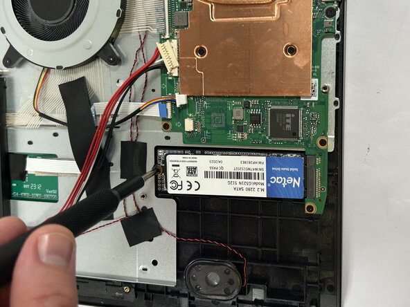

  5. SGIN X15S M.2 SSD Replacement, M.2 SSD: crwdns2935265:05crwdnd2935265:01crwdnd2935265:02crwdne2935265:0 SGIN X15S M.2 SSD Replacement, M.2 SSD: crwdns2935265:05crwdnd2935265:02crwdnd2935265:02crwdne2935265:0
    • Remove the single 3 mm screw holding the SSD in place using a Phillips #0 screwdriver.
  6. SGIN X15S M.2 SSD Replacement: crwdns2935265:06crwdnd2935265:01crwdnd2935265:03crwdne2935265:0 SGIN X15S M.2 SSD Replacement: crwdns2935265:06crwdnd2935265:02crwdnd2935265:03crwdne2935265:0 SGIN X15S M.2 SSD Replacement: crwdns2935265:06crwdnd2935265:03crwdnd2935265:03crwdne2935265:0

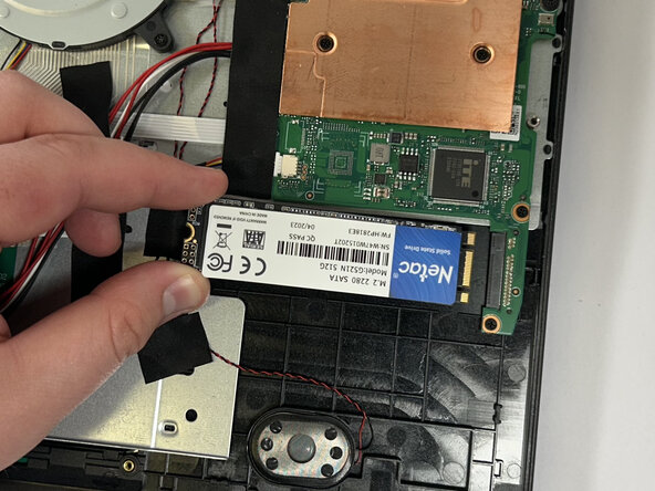

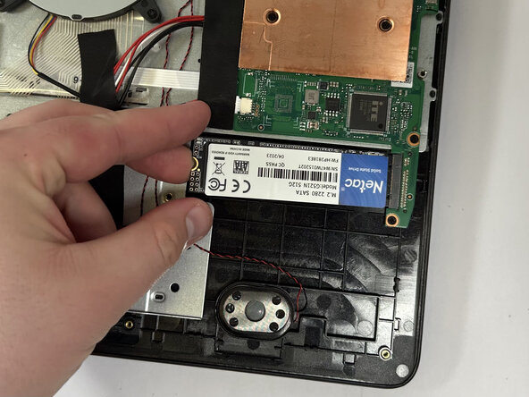

    • Give the SSD a little upward force near the screw side so that it is bent at an angle.
    • Pull the SSD out of its slot.
