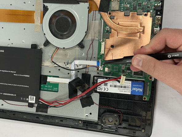

  5. SGIN X15S Fan Replacement, Fan: crwdns2935265:05crwdnd2935265:01crwdnd2935265:02crwdne2935265:0 SGIN X15S Fan Replacement, Fan: crwdns2935265:05crwdnd2935265:02crwdnd2935265:02crwdne2935265:0
    • Using the tweezers, grab the wire connector.
    • When removing connectors, be sure to grip the edges of the wire connector and not the wires themselves.
    • With the tweezers in place, push away from the motherboard to disconnect the wire.

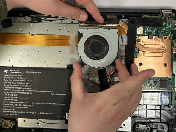

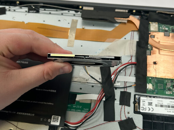

  6. SGIN X15S Fan Replacement: crwdns2935265:06crwdnd2935265:01crwdnd2935265:03crwdne2935265:0 SGIN X15S Fan Replacement: crwdns2935265:06crwdnd2935265:02crwdnd2935265:03crwdne2935265:0 SGIN X15S Fan Replacement: crwdns2935265:06crwdnd2935265:03crwdnd2935265:03crwdne2935265:0
    • Remove the three 5.5 mm screws holding the fan in place using a Phillips #0 screwdriver.
    • Pull the thermal pad off of the fan.
    • Pull the fan, hooked by magnets, away from the heatsink.
