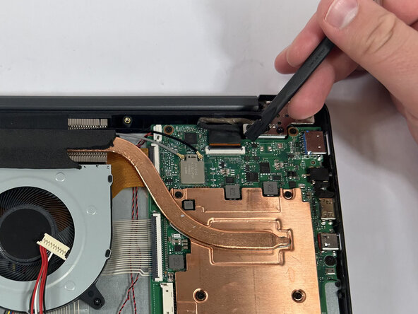

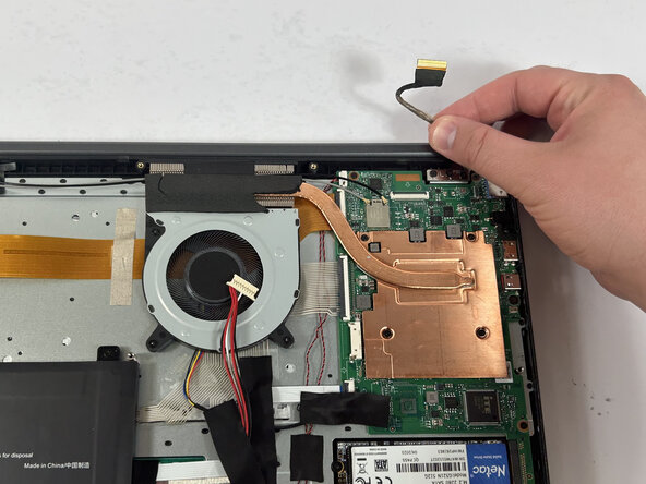

  5. SGIN X15S Display Assembly Replacement, Display Assembly: crwdns2935265:05crwdnd2935265:01crwdnd2935265:03crwdne2935265:0 SGIN X15S Display Assembly Replacement, Display Assembly: crwdns2935265:05crwdnd2935265:02crwdnd2935265:03crwdne2935265:0 SGIN X15S Display Assembly Replacement, Display Assembly: crwdns2935265:05crwdnd2935265:03crwdnd2935265:03crwdne2935265:0
    • Using a nylon spudger, release the lock on the cable connected to the screen.
    • Remove the cable from the lock.

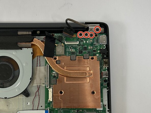

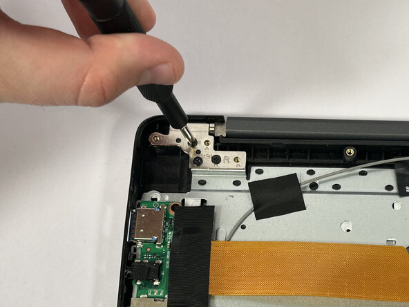

  6. SGIN X15S Display Assembly Replacement: crwdns2935265:06crwdnd2935265:01crwdnd2935265:03crwdne2935265:0 SGIN X15S Display Assembly Replacement: crwdns2935265:06crwdnd2935265:02crwdnd2935265:03crwdne2935265:0 SGIN X15S Display Assembly Replacement: crwdns2935265:06crwdnd2935265:03crwdnd2935265:03crwdne2935265:0
    • Remove the eight 3.4 mm screws from the metal brackets holding the screen to the rest of the computer using a Phillips #0 screwdriver.
    • There will be four screws per bracket.

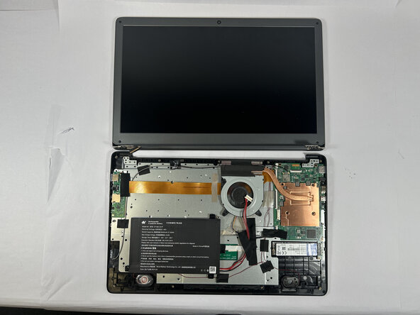

  7. SGIN X15S Display Assembly Replacement: crwdns2935265:07crwdnd2935265:01crwdnd2935265:02crwdne2935265:0 SGIN X15S Display Assembly Replacement: crwdns2935265:07crwdnd2935265:02crwdnd2935265:02crwdne2935265:0
    • Place the laptop on its side.
    • Gently open the laptop and remove the display assembly.
    • If the screen has any cracks be careful of hand placement when opening the screen and/or wear gloves to avoid cuts.
