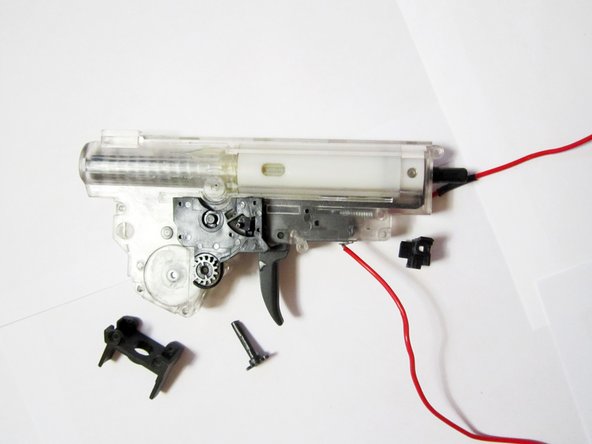

      • Pull apart the cover when pulling the gearbox out.
      • Pull the gearbox out.
      • The gears will fall out when taking the gearbox out. Careful not to lose them.

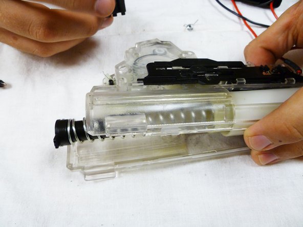

    1. SG 552-1 Commando Trigger Replacement, Trigger: crwdns2935265:013crwdnd2935265:01crwdnd2935265:02crwdne2935265:0 SG 552-1 Commando Trigger Replacement, Trigger: crwdns2935265:013crwdnd2935265:02crwdnd2935265:02crwdne2935265:0
      • Using a Phillips #1 screwdriver, remove the following screws:
      • Remove these four 15mm screws.
      • Remove this single 8mm screw.
      • Using a Phillips #0 screwdriver, remove the following screws:
      • Remove this single 14mm screw.
      • Remove this single 3mm screw.
      • Detach the pieces unscrewed from the gearbox.

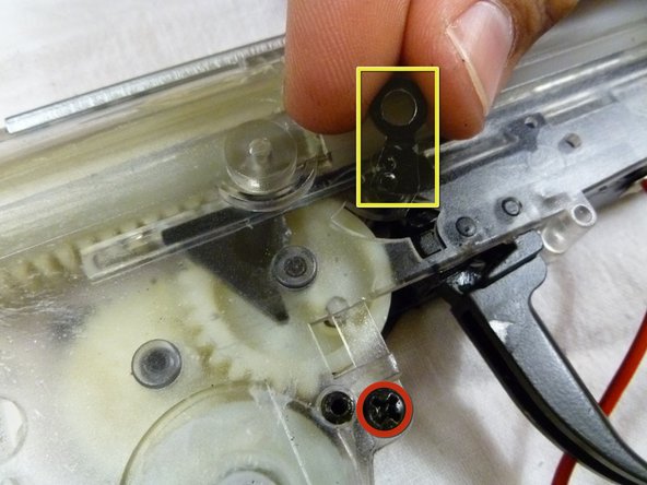

    2. SG 552-1 Commando Trigger Replacement: crwdns2935265:014crwdnd2935265:01crwdnd2935265:02crwdne2935265:0 SG 552-1 Commando Trigger Replacement: crwdns2935265:014crwdnd2935265:02crwdnd2935265:02crwdne2935265:0
      • Remove the cover over the trigger.
      • Remove the safety piece.
      • Using a Phillips #1 screwdriver, remove the 18mm screw beside the trigger.
    3. SG 552-1 Commando Trigger Replacement: crwdns2935265:015crwdnd2935265:01crwdnd2935265:02crwdne2935265:0 SG 552-1 Commando Trigger Replacement: crwdns2935265:015crwdnd2935265:02crwdnd2935265:02crwdne2935265:0
      • Remove the metal piece.
      • Removal of this piece will permanently damage the metal piece.
      • Remove the cover for the gearbox.
    4. SG 552-1 Commando Trigger Replacement: crwdns2935265:016crwdnd2935265:01crwdnd2935265:01crwdne2935265:0
      • Pull the trigger off the gearbox.
