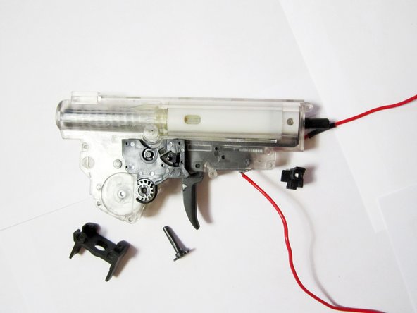

    1. SG 552-1 Commando Spring Replacement, Spring: crwdns2935265:013crwdnd2935265:01crwdnd2935265:02crwdne2935265:0 SG 552-1 Commando Spring Replacement, Spring: crwdns2935265:013crwdnd2935265:02crwdnd2935265:02crwdne2935265:0
      • Using a Phillips #1 screwdriver, remove the following screws:
      • Remove these four 15mm screws.
      • Remove this single 8mm screw.
      • Using a Phillips #0 screwdriver, remove the following screws:
      • Remove this single 3mm screw.
      • Remove this single 14mm screw.
      • Detach the pieces unscrewed from the gearbox.

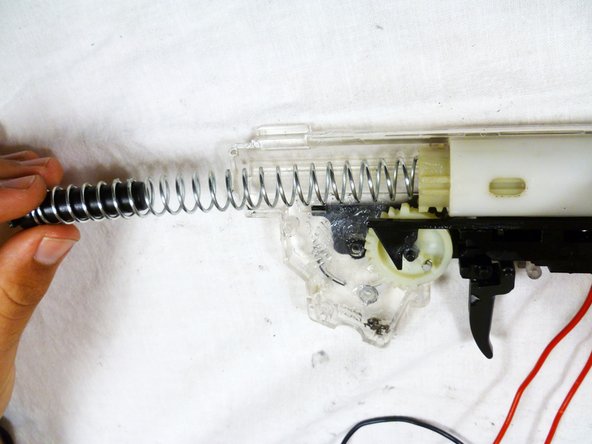

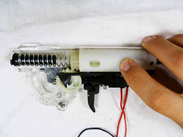

    2. SG 552-1 Commando Spring Replacement: crwdns2935265:014crwdnd2935265:01crwdnd2935265:02crwdne2935265:0 SG 552-1 Commando Spring Replacement: crwdns2935265:014crwdnd2935265:02crwdnd2935265:02crwdne2935265:0
      • Remove the piece covering the trigger.
      • Remove the safety piece.
      • Using a Phillips #1 screwdriver, remove the 18mm screw beside the trigger.
    3. SG 552-1 Commando Spring Replacement: crwdns2935265:015crwdnd2935265:01crwdnd2935265:01crwdne2935265:0
      • Remove the metal piece.
      • Removing this piece will permanently damage the metal piece.
    4. SG 552-1 Commando Spring Replacement: crwdns2935265:016crwdnd2935265:01crwdnd2935265:03crwdne2935265:0 SG 552-1 Commando Spring Replacement: crwdns2935265:016crwdnd2935265:02crwdnd2935265:03crwdne2935265:0 SG 552-1 Commando Spring Replacement: crwdns2935265:016crwdnd2935265:03crwdnd2935265:03crwdne2935265:0
      • Remove the cover and pull out the spring.
