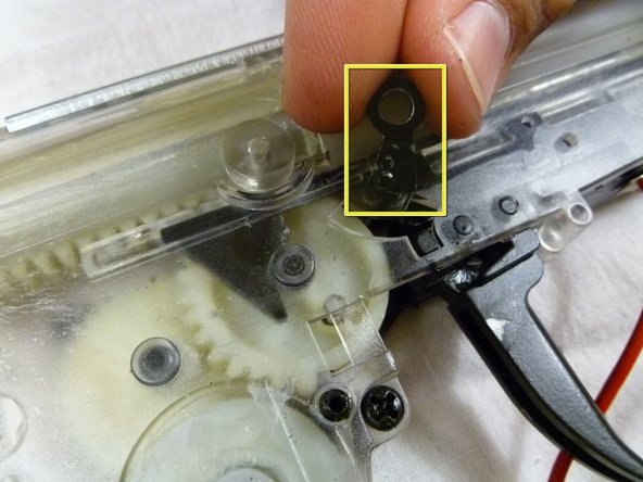

  13. SG 552-1 Commando Safety Replacement, Safety: crwdns2935265:013crwdnd2935265:01crwdnd2935265:01crwdne2935265:0
    • Using a Phillips #0 screwdriver, remove the single 3mm screw holding the safety/trigger cover in place.
  14. SG 552-1 Commando Safety Replacement: crwdns2935265:014crwdnd2935265:01crwdnd2935265:02crwdne2935265:0 SG 552-1 Commando Safety Replacement: crwdns2935265:014crwdnd2935265:02crwdnd2935265:02crwdne2935265:0
    • Remove the cover over the trigger.
    • The safety is located underneath the cover.
