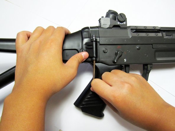

      • Using a flathead screwdriver, remove the pin holding the hand guard in place.
      • To remove this, turn the pin clockwise and push it through at the same time.
      • Remove the hand guard.

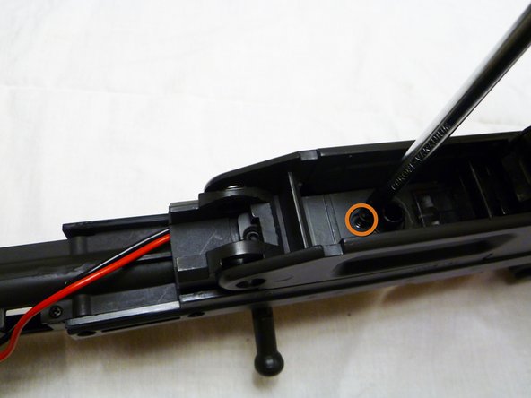

      • Remove the 8mm screw that is located directly underneath the cocking lever.
      • Remove the 8mm screw located beside the screw you just removed.
    4. SG 552-1 Commando Gearbox Replacement: crwdns2935265:04crwdnd2935265:01crwdnd2935265:02crwdne2935265:0 SG 552-1 Commando Gearbox Replacement: crwdns2935265:04crwdnd2935265:02crwdnd2935265:02crwdne2935265:0

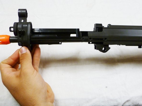

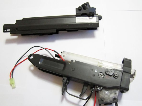

      • Carefully tug on the tip of the gun and pull the barrel and its cover out.
    5. SG 552-1 Commando Gearbox Replacement: crwdns2935265:05crwdnd2935265:01crwdnd2935265:03crwdne2935265:0 SG 552-1 Commando Gearbox Replacement: crwdns2935265:05crwdnd2935265:02crwdnd2935265:03crwdne2935265:0 SG 552-1 Commando Gearbox Replacement: crwdns2935265:05crwdnd2935265:03crwdnd2935265:03crwdne2935265:0

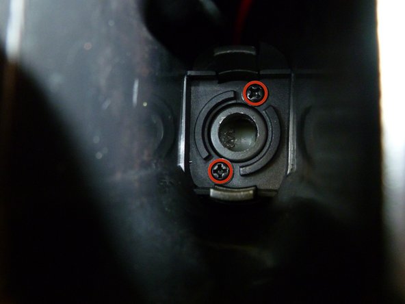

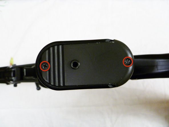

      • Locate the hand grip.
      • Using a Phillips #0 screwdriver, remove the two 6mm screws at the bottom of the hand grip.
      • Slide the cover off.

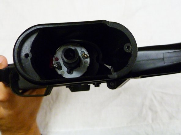

      • Pull the motor out of the hand grip.
      • Using a Phillips #1 screwdriver, remove the two 5mm screws inside of the hand grip.

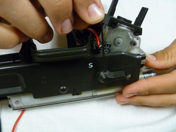

      • Using a Phillips #1 screwdriver, remove the 20mm screw behind the folding stock and above the gearbox.
      • Remove the cover that was held on by the screw.
    9. SG 552-1 Commando Gearbox Replacement: crwdns2935265:09crwdnd2935265:01crwdnd2935265:03crwdne2935265:0 SG 552-1 Commando Gearbox Replacement: crwdns2935265:09crwdnd2935265:02crwdnd2935265:03crwdne2935265:0 SG 552-1 Commando Gearbox Replacement: crwdns2935265:09crwdnd2935265:03crwdnd2935265:03crwdne2935265:0
      • Using a flathead screwdriver, remove the two 5mm screws beside the safety switch on both sides of the gun.
      • Slide off the piece that was held on by those screws.
    10. SG 552-1 Commando Gearbox Replacement: crwdns2935265:010crwdnd2935265:01crwdnd2935265:02crwdne2935265:0 SG 552-1 Commando Gearbox Replacement: crwdns2935265:010crwdnd2935265:02crwdnd2935265:02crwdne2935265:0
      • Using a small allen wrench, carefully unscrew the screws holding the safety switch in place on both sides of the gun.
      • The screws do not have to be taken out all the way, just slightly loosen them until you are able to pull the switch off.

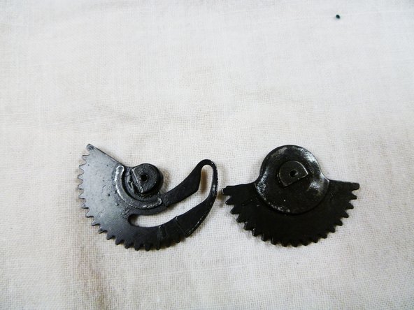

    12. SG 552-1 Commando Gearbox Replacement: crwdns2935265:012crwdnd2935265:01crwdnd2935265:03crwdne2935265:0 SG 552-1 Commando Gearbox Replacement: crwdns2935265:012crwdnd2935265:02crwdnd2935265:03crwdne2935265:0 SG 552-1 Commando Gearbox Replacement: crwdns2935265:012crwdnd2935265:03crwdnd2935265:03crwdne2935265:0

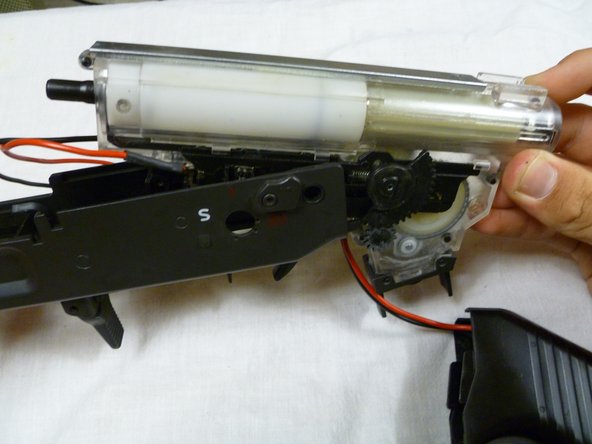

      • Pull apart the cover when pulling the gearbox out.
      • Pull the gearbox out.
      • The gears will fall out when taking the gearbox out. Careful not to lose them.
