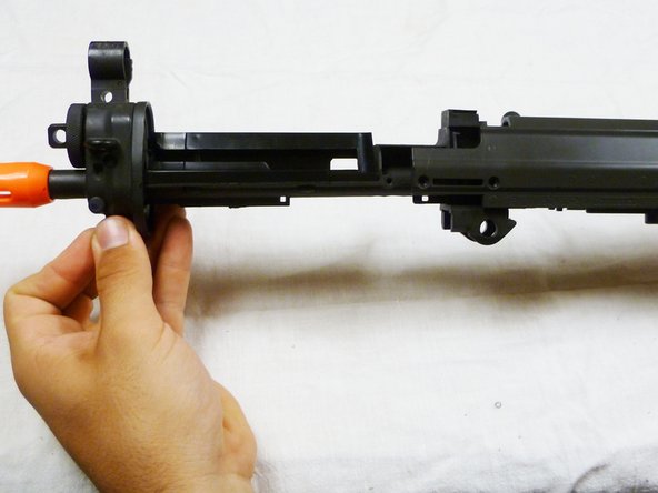

  5. SG 552-1 Commando Barrel Replacement: crwdns2935265:05crwdnd2935265:01crwdnd2935265:02crwdne2935265:0 SG 552-1 Commando Barrel Replacement: crwdns2935265:05crwdnd2935265:02crwdnd2935265:02crwdne2935265:0
    • Carefully tug on the tip of the gun and pull the barrel and its cover out.

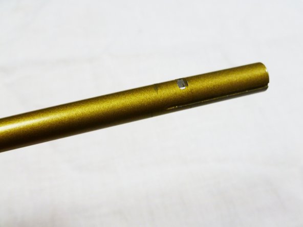

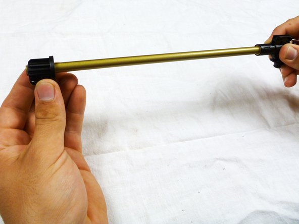

  6. SG 552-1 Commando Barrel Replacement: crwdns2935265:06crwdnd2935265:01crwdnd2935265:03crwdne2935265:0 SG 552-1 Commando Barrel Replacement: crwdns2935265:06crwdnd2935265:02crwdnd2935265:03crwdne2935265:0 SG 552-1 Commando Barrel Replacement: crwdns2935265:06crwdnd2935265:03crwdnd2935265:03crwdne2935265:0
    • Pull the barrel out from the cover.
    • Remove the pieces at the end of the barrel.

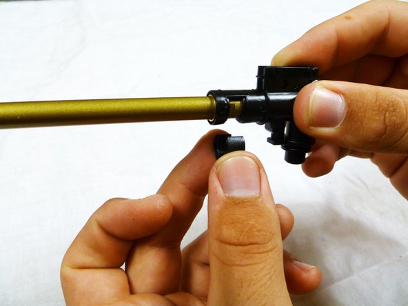

  7. SG 552-1 Commando Barrel Replacement: crwdns2935265:07crwdnd2935265:01crwdnd2935265:02crwdne2935265:0 SG 552-1 Commando Barrel Replacement: crwdns2935265:07crwdnd2935265:02crwdnd2935265:02crwdne2935265:0
    • Remove the remaining pieces of on the ends of the barrel.
