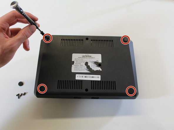

    • Use your fingers to peel off the four corner rubber feet on the bottom.
    • Use the Phillips #000 screwdriver to remove the four screws beneath the rubber feet.

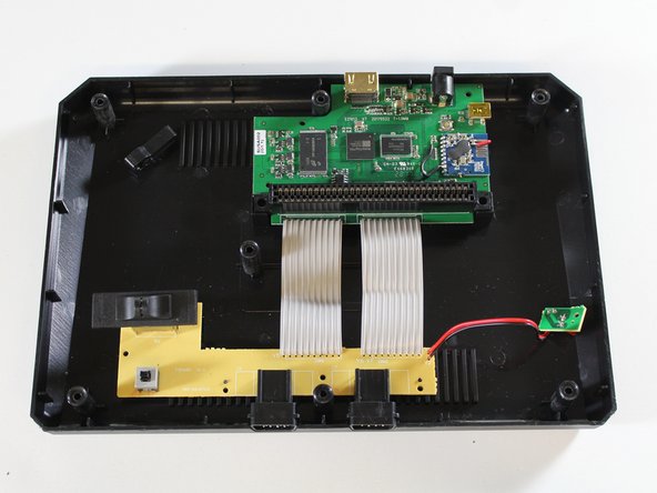

  5. SEGA Genesis Flashback Motherboard Replacement, Motherboard: crwdns2935265:05crwdnd2935265:01crwdnd2935265:01crwdne2935265:0
    • Unscrew the LED board on the inside of the top plate with the Phillips #000 screwdriver.
    • Note: The top plate is no longer needed for the next steps, so you can feel free to set it aside until reassembly.
  6. SEGA Genesis Flashback Motherboard Replacement: crwdns2935265:06crwdnd2935265:01crwdnd2935265:02crwdne2935265:0 SEGA Genesis Flashback Motherboard Replacement: crwdns2935265:06crwdnd2935265:02crwdnd2935265:02crwdne2935265:0
    • Use the Phillips #000 screwdriver to remove the five screws circled in the provided picture.
    • The tan board can now detach from the rest of the case, as pictured, but you can feel free to leave it in place for now.

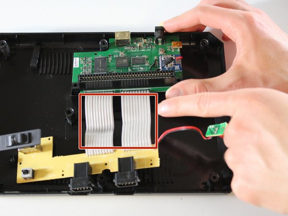

    • CAUTION: Do not disconnect the tan power switch board from the grey ribbon cables.

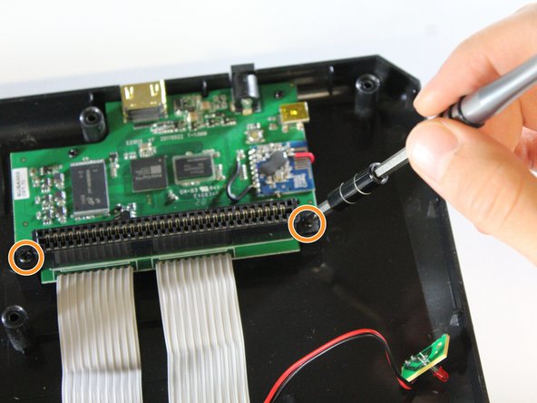

    • Remove the smaller screws located on the green motherboard with the Phillips #000 screwdriver.
    • Remove the two larger screws holding down the game cartridge slot with the Phillips #1 screwdriver.

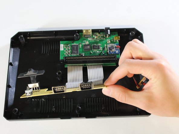

    • Gently remove the motherboard and the connected tan power switch board from the bottom plate.
    • CAUTION: Be sure not to rip the ribbon cables connecting the motherboard and tan power switch board.
