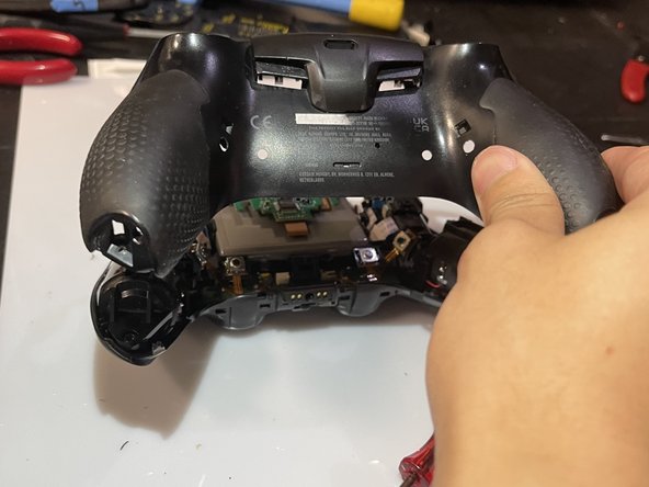

  7. SCUF Reflex Joystick Replacement, Remove the rear case: crwdns2935265:07crwdnd2935265:01crwdnd2935265:02crwdne2935265:0 SCUF Reflex Joystick Replacement, Remove the rear case: crwdns2935265:07crwdnd2935265:02crwdnd2935265:02crwdne2935265:0
    • Slide the prying tool down the edge of the rear casing of the controller to remove the rear case.
    • Be sure to deal with all the clips!

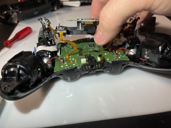

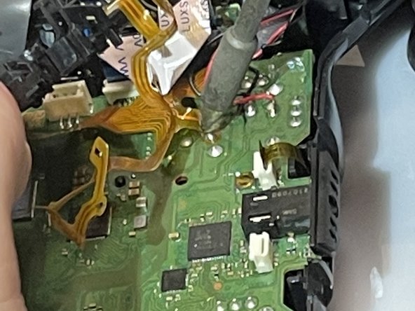

  11. SCUF Reflex Joystick Replacement, Desolder the ribbon cables: crwdns2935265:011crwdnd2935265:01crwdnd2935265:02crwdne2935265:0 SCUF Reflex Joystick Replacement, Desolder the ribbon cables: crwdns2935265:011crwdnd2935265:02crwdnd2935265:02crwdne2935265:0
    • Use a soldering iron to desolder the ribbon cables on the motherboard.
  12. SCUF Reflex Joystick Replacement: crwdns2935265:012crwdnd2935265:01crwdnd2935265:01crwdne2935265:0
    • Unplug these four cables from the motherboard.
  13. SCUF Reflex Joystick Replacement: crwdns2935265:013crwdnd2935265:01crwdnd2935265:01crwdne2935265:0
    • Use the soldering iron to desolder the black and red wires off of the motherboard.
  14. SCUF Reflex Joystick Replacement: crwdns2935265:014crwdnd2935265:01crwdnd2935265:01crwdne2935265:0
    • Remove the motherboard and the battery bracket from the controller to expose the joystick component.
