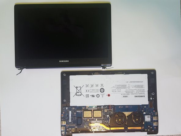

    • Remove the ten 4.3mm Phillips #00 screws from the bottom cover of the laptop.
  2. SAMSUNG ATIV Book 9 Plus NP930X5J-S01US Screen Replacement: crwdns2935265:02crwdnd2935265:01crwdnd2935265:03crwdne2935265:0 SAMSUNG ATIV Book 9 Plus NP930X5J-S01US Screen Replacement: crwdns2935265:02crwdnd2935265:02crwdnd2935265:03crwdne2935265:0 SAMSUNG ATIV Book 9 Plus NP930X5J-S01US Screen Replacement: crwdns2935265:02crwdnd2935265:03crwdnd2935265:03crwdne2935265:0
    • Press the button to release the bottom cover.
  3. SAMSUNG ATIV Book 9 Plus NP930X5J-S01US Screen Replacement: crwdns2935265:03crwdnd2935265:01crwdnd2935265:02crwdne2935265:0 SAMSUNG ATIV Book 9 Plus NP930X5J-S01US Screen Replacement: crwdns2935265:03crwdnd2935265:02crwdnd2935265:02crwdne2935265:0

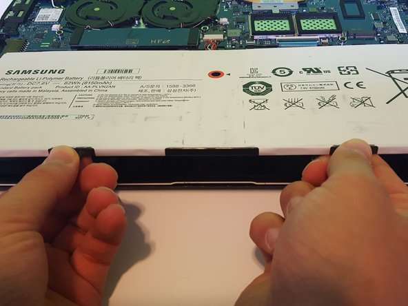

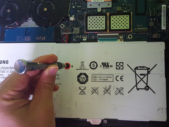

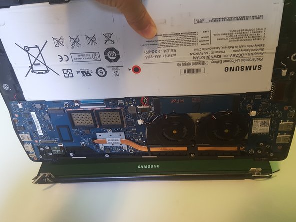

    • Remove the five 4.3mm Phillips #00 screws from the battery.
  4. SAMSUNG ATIV Book 9 Plus NP930X5J-S01US Screen Replacement: crwdns2935265:04crwdnd2935265:01crwdnd2935265:02crwdne2935265:0 SAMSUNG ATIV Book 9 Plus NP930X5J-S01US Screen Replacement: crwdns2935265:04crwdnd2935265:02crwdnd2935265:02crwdne2935265:0
    • Lift the battery with both hands and remove.
  5. SAMSUNG ATIV Book 9 Plus NP930X5J-S01US Screen Replacement, Screen: crwdns2935265:05crwdnd2935265:01crwdnd2935265:03crwdne2935265:0 SAMSUNG ATIV Book 9 Plus NP930X5J-S01US Screen Replacement, Screen: crwdns2935265:05crwdnd2935265:02crwdnd2935265:03crwdne2935265:0 SAMSUNG ATIV Book 9 Plus NP930X5J-S01US Screen Replacement, Screen: crwdns2935265:05crwdnd2935265:03crwdnd2935265:03crwdne2935265:0

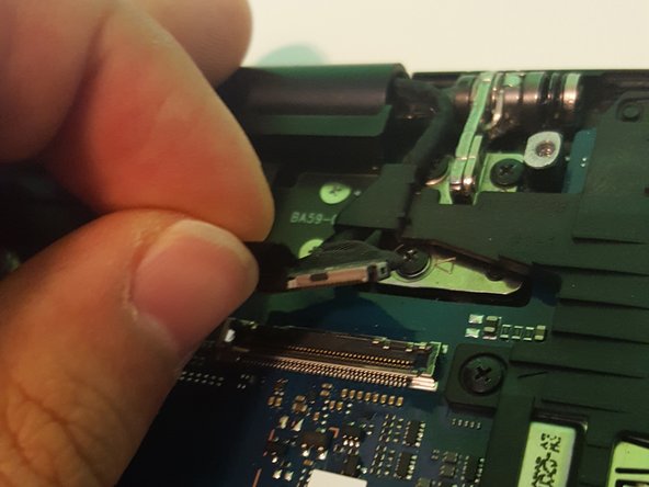

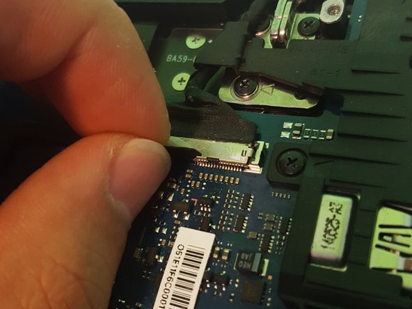

    • Disconnect the display cable from the motherboard.
  6. SAMSUNG ATIV Book 9 Plus NP930X5J-S01US Screen Replacement: crwdns2935265:06crwdnd2935265:01crwdnd2935265:02crwdne2935265:0 SAMSUNG ATIV Book 9 Plus NP930X5J-S01US Screen Replacement: crwdns2935265:06crwdnd2935265:02crwdnd2935265:02crwdne2935265:0

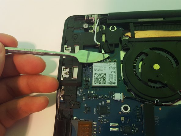

    • Disconnect the black and white antenna cables from the Wi-Fi card.
  7. SAMSUNG ATIV Book 9 Plus NP930X5J-S01US Screen Replacement: crwdns2935265:07crwdnd2935265:01crwdnd2935265:02crwdne2935265:0 SAMSUNG ATIV Book 9 Plus NP930X5J-S01US Screen Replacement: crwdns2935265:07crwdnd2935265:02crwdnd2935265:02crwdne2935265:0

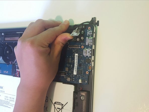

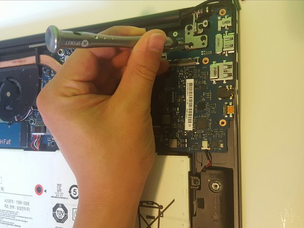

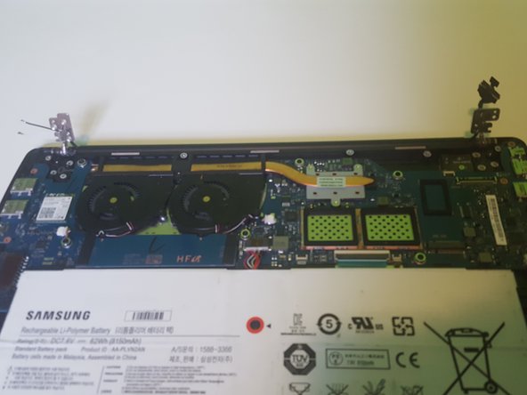

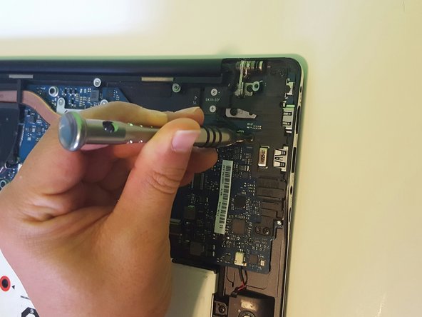

    • Remove the five 4mm Phillips #00 screws from the motherboard retaining brackets.
  8. SAMSUNG ATIV Book 9 Plus NP930X5J-S01US Screen Replacement: crwdns2935265:08crwdnd2935265:01crwdnd2935265:02crwdne2935265:0 SAMSUNG ATIV Book 9 Plus NP930X5J-S01US Screen Replacement: crwdns2935265:08crwdnd2935265:02crwdnd2935265:02crwdne2935265:0
    • Remove the eight silver 4.2mm Phillips #00 screws from the corner.
  9. SAMSUNG ATIV Book 9 Plus NP930X5J-S01US Screen Replacement: crwdns2935265:09crwdnd2935265:01crwdnd2935265:03crwdne2935265:0 SAMSUNG ATIV Book 9 Plus NP930X5J-S01US Screen Replacement: crwdns2935265:09crwdnd2935265:02crwdnd2935265:03crwdne2935265:0 SAMSUNG ATIV Book 9 Plus NP930X5J-S01US Screen Replacement: crwdns2935265:09crwdnd2935265:03crwdnd2935265:03crwdne2935265:0
    • Pry up the metal hinges from the laptop.
  10. SAMSUNG ATIV Book 9 Plus NP930X5J-S01US Screen Replacement: crwdns2935265:010crwdnd2935265:01crwdnd2935265:03crwdne2935265:0 SAMSUNG ATIV Book 9 Plus NP930X5J-S01US Screen Replacement: crwdns2935265:010crwdnd2935265:02crwdnd2935265:03crwdne2935265:0 SAMSUNG ATIV Book 9 Plus NP930X5J-S01US Screen Replacement: crwdns2935265:010crwdnd2935265:03crwdnd2935265:03crwdne2935265:0
    • Place the screen on its back side and hold the battery-side of the laptop. In an upward motion, remove the back set off and set it aside.

There’s no need to remove the battery. Just disconnect its power socket if you want to be ‘careful’.
