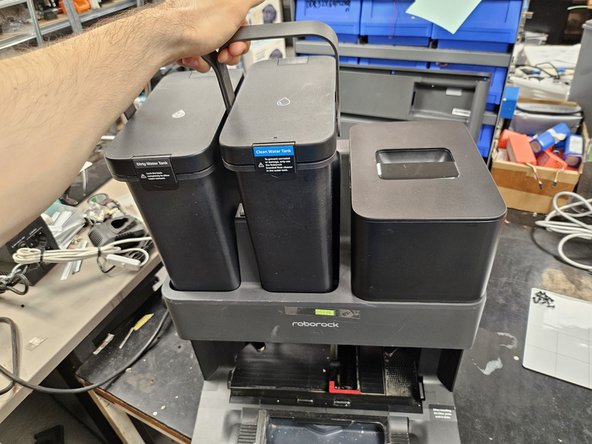

  1. S7 MaxV Ultra dock: Suction fan replacement, Remove the water tanks and dustbin cover.: crwdns2935265:01crwdnd2935265:01crwdnd2935265:03crwdne2935265:0 S7 MaxV Ultra dock: Suction fan replacement, Remove the water tanks and dustbin cover.: crwdns2935265:01crwdnd2935265:02crwdnd2935265:03crwdne2935265:0 S7 MaxV Ultra dock: Suction fan replacement, Remove the water tanks and dustbin cover.: crwdns2935265:01crwdnd2935265:03crwdnd2935265:03crwdne2935265:0

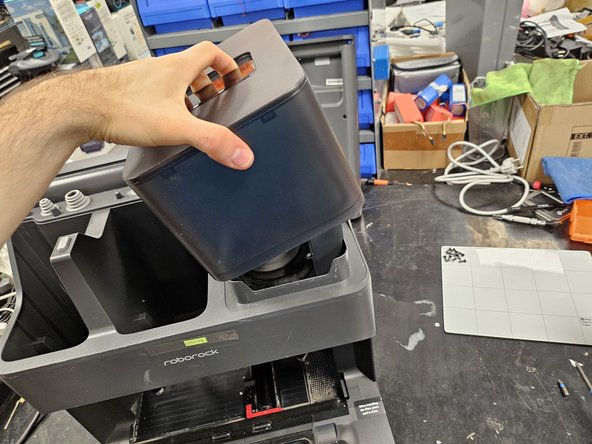

    • Remove the water tanks and the dustbin cover.

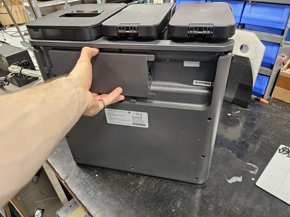

  2. S7 MaxV Ultra dock: Suction fan replacement, Remove the back cover.: crwdns2935265:02crwdnd2935265:01crwdnd2935265:03crwdne2935265:0 S7 MaxV Ultra dock: Suction fan replacement, Remove the back cover.: crwdns2935265:02crwdnd2935265:02crwdnd2935265:03crwdne2935265:0 S7 MaxV Ultra dock: Suction fan replacement, Remove the back cover.: crwdns2935265:02crwdnd2935265:03crwdnd2935265:03crwdne2935265:0
    • Remove the screws using a PH2 screwdriver.
    • Pull the back cover off.

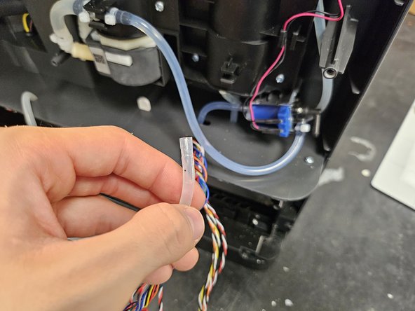

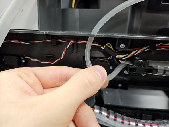

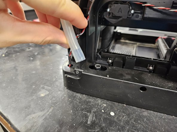

  4. S7 MaxV Ultra dock: Suction fan replacement, Remove the maintenance brush water output tube.: crwdns2935265:04crwdnd2935265:01crwdnd2935265:03crwdne2935265:0 S7 MaxV Ultra dock: Suction fan replacement, Remove the maintenance brush water output tube.: crwdns2935265:04crwdnd2935265:02crwdnd2935265:03crwdne2935265:0 S7 MaxV Ultra dock: Suction fan replacement, Remove the maintenance brush water output tube.: crwdns2935265:04crwdnd2935265:03crwdnd2935265:03crwdne2935265:0
    • Remove the zip-tie.
    • Disconnect the maintenance brush water output tube.

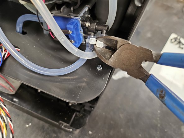

  5. S7 MaxV Ultra dock: Suction fan replacement, Disconnect the water intake tube.: crwdns2935265:05crwdnd2935265:01crwdnd2935265:02crwdne2935265:0 S7 MaxV Ultra dock: Suction fan replacement, Disconnect the water intake tube.: crwdns2935265:05crwdnd2935265:02crwdnd2935265:02crwdne2935265:0
    • Cut off the ziptie.
    • Disconnect the tube from the valve.

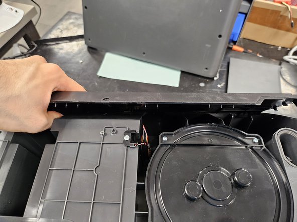

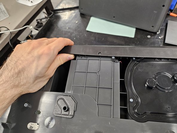

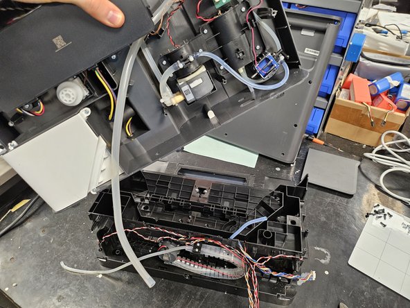

  7. S7 MaxV Ultra dock: Suction fan replacement: crwdns2935265:07crwdnd2935265:01crwdnd2935265:02crwdne2935265:0 S7 MaxV Ultra dock: Suction fan replacement: crwdns2935265:07crwdnd2935265:02crwdnd2935265:02crwdne2935265:0
    • Push the wires and tube through the holes into the bottom half of the dock.

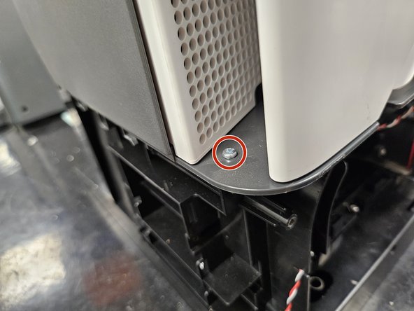

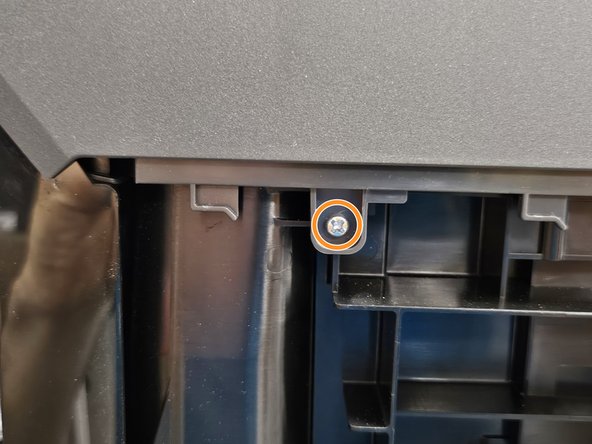

  8. S7 MaxV Ultra dock: Suction fan replacement, Remove the right side panel.: crwdns2935265:08crwdnd2935265:01crwdnd2935265:03crwdne2935265:0 S7 MaxV Ultra dock: Suction fan replacement, Remove the right side panel.: crwdns2935265:08crwdnd2935265:02crwdnd2935265:03crwdne2935265:0 S7 MaxV Ultra dock: Suction fan replacement, Remove the right side panel.: crwdns2935265:08crwdnd2935265:03crwdnd2935265:03crwdne2935265:0
    • Remove the marked screw using a PH2 screwdriver.
    • Push the side panel towards yourself.
    • Remove the screw using a PH2 screwdriver.

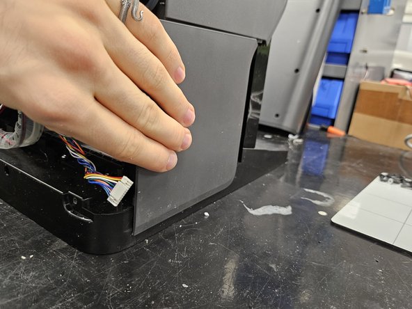

  9. S7 MaxV Ultra dock: Suction fan replacement, Remove the left side panel.: crwdns2935265:09crwdnd2935265:01crwdnd2935265:02crwdne2935265:0 S7 MaxV Ultra dock: Suction fan replacement, Remove the left side panel.: crwdns2935265:09crwdnd2935265:02crwdnd2935265:02crwdne2935265:0
    • Remove the screw using a PH2 screwdriver, then slide the panel off.

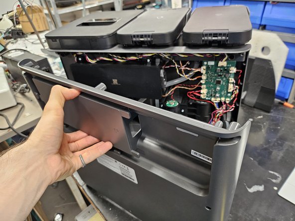

  13. S7 MaxV Ultra dock: Suction fan replacement, Remove the front cover of the dock.: crwdns2935265:013crwdnd2935265:01crwdnd2935265:03crwdne2935265:0 S7 MaxV Ultra dock: Suction fan replacement, Remove the front cover of the dock.: crwdns2935265:013crwdnd2935265:02crwdnd2935265:03crwdne2935265:0 S7 MaxV Ultra dock: Suction fan replacement, Remove the front cover of the dock.: crwdns2935265:013crwdnd2935265:03crwdnd2935265:03crwdne2935265:0
    • Remove the marked screws using a PH1 screwdriver.
    • Pull the front cover off. It is still held in place by a couple latches.

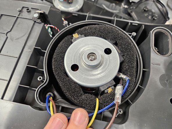

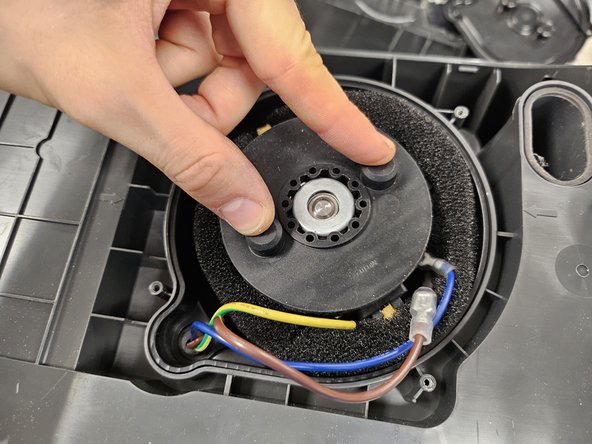

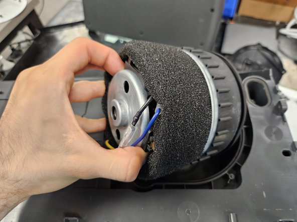

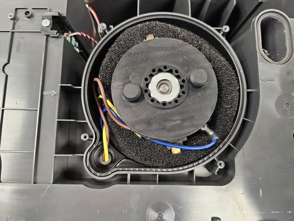

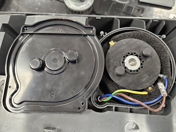

  15. S7 MaxV Ultra dock: Suction fan replacement, Remove the suction fan.: crwdns2935265:015crwdnd2935265:01crwdnd2935265:03crwdne2935265:0 S7 MaxV Ultra dock: Suction fan replacement, Remove the suction fan.: crwdns2935265:015crwdnd2935265:02crwdnd2935265:03crwdne2935265:0 S7 MaxV Ultra dock: Suction fan replacement, Remove the suction fan.: crwdns2935265:015crwdnd2935265:03crwdnd2935265:03crwdne2935265:0
    • Remove the rubber cap.
    • Take the suction fan out.
    • Pull the foam further down the wires to expose all the connectors, then disconnect those.
  16. S7 MaxV Ultra dock: Suction fan replacement, Replace the suction fan.: crwdns2935265:016crwdnd2935265:01crwdnd2935265:02crwdne2935265:0 S7 MaxV Ultra dock: Suction fan replacement, Replace the suction fan.: crwdns2935265:016crwdnd2935265:02crwdnd2935265:02crwdne2935265:0
    • Connect the connectors on the new suction fan, then fit the foam over it.
    • Place it back inside.

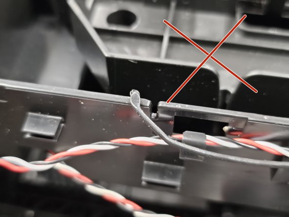

  18. S7 MaxV Ultra dock: Suction fan replacement, Ensure the cables are in proper grooves.: crwdns2935265:018crwdnd2935265:01crwdnd2935265:03crwdne2935265:0 S7 MaxV Ultra dock: Suction fan replacement, Ensure the cables are in proper grooves.: crwdns2935265:018crwdnd2935265:02crwdnd2935265:03crwdne2935265:0 S7 MaxV Ultra dock: Suction fan replacement, Ensure the cables are in proper grooves.: crwdns2935265:018crwdnd2935265:03crwdnd2935265:03crwdne2935265:0
    • When putting the halves together, make sure the cables are in their correct grooves.
