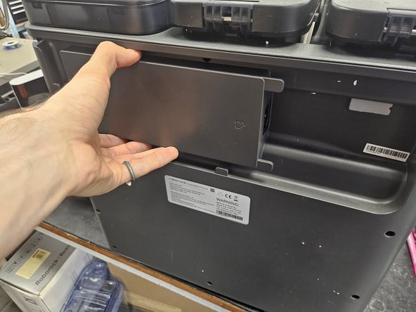

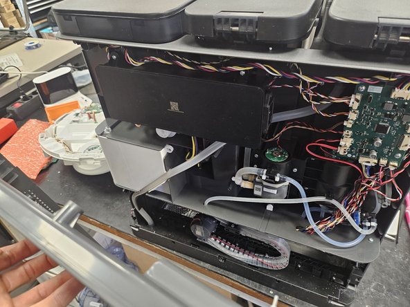

  1. S7 MaxV Ultra Dock: Motherboard replacement, Removing the back cover: crwdns2935265:01crwdnd2935265:01crwdnd2935265:03crwdne2935265:0 S7 MaxV Ultra Dock: Motherboard replacement, Removing the back cover: crwdns2935265:01crwdnd2935265:02crwdnd2935265:03crwdne2935265:0 S7 MaxV Ultra Dock: Motherboard replacement, Removing the back cover: crwdns2935265:01crwdnd2935265:03crwdnd2935265:03crwdne2935265:0
    • Remove the marked screws.
    • Pull the back cover off.

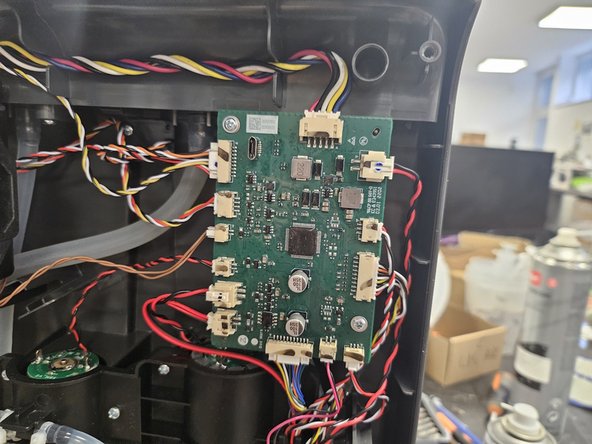

  2. S7 MaxV Ultra Dock: Motherboard replacement, Disconnect the motherboard.: crwdns2935265:02crwdnd2935265:01crwdnd2935265:02crwdne2935265:0 S7 MaxV Ultra Dock: Motherboard replacement, Disconnect the motherboard.: crwdns2935265:02crwdnd2935265:02crwdnd2935265:02crwdne2935265:0
    • Disconnect the cables from the motherboard.
    • The motherboard is in the top right of the dock itself.

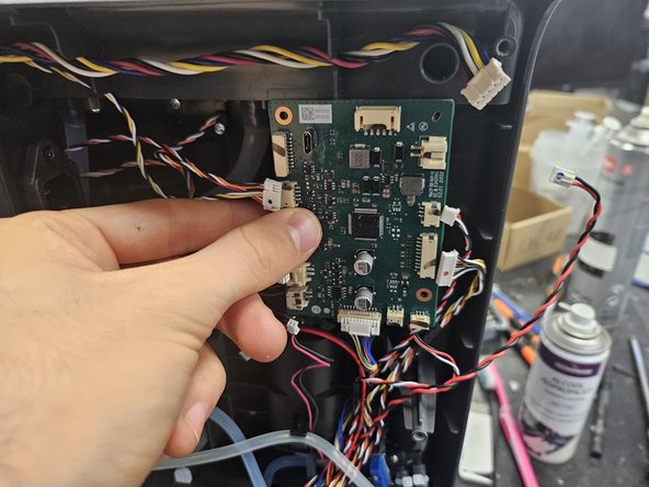

  3. S7 MaxV Ultra Dock: Motherboard replacement, Remove the motherboard.: crwdns2935265:03crwdnd2935265:01crwdnd2935265:03crwdne2935265:0 S7 MaxV Ultra Dock: Motherboard replacement, Remove the motherboard.: crwdns2935265:03crwdnd2935265:02crwdnd2935265:03crwdne2935265:0 S7 MaxV Ultra Dock: Motherboard replacement, Remove the motherboard.: crwdns2935265:03crwdnd2935265:03crwdnd2935265:03crwdne2935265:0
    • Remove the screws.
    • Once those are removed, take the motherboard out.

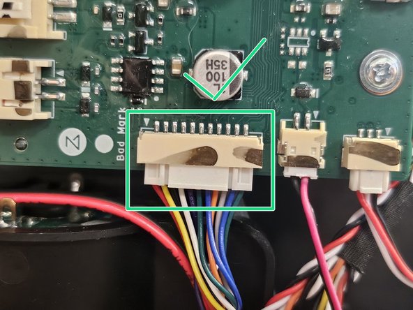

  4. S7 MaxV Ultra Dock: Motherboard replacement, Caution!: crwdns2935265:04crwdnd2935265:01crwdnd2935265:03crwdne2935265:0 S7 MaxV Ultra Dock: Motherboard replacement, Caution!: crwdns2935265:04crwdnd2935265:02crwdnd2935265:03crwdne2935265:0 S7 MaxV Ultra Dock: Motherboard replacement, Caution!: crwdns2935265:04crwdnd2935265:03crwdnd2935265:03crwdne2935265:0
    • When connecting the cables to a new motherboard, ensure all connectors are fully connected.
  5. S7 MaxV Ultra Dock: Motherboard replacement, Screeeeeeeeeews: crwdns2935265:05crwdnd2935265:01crwdnd2935265:01crwdne2935265:0
    • Here are the screws organised by steps and size.
    • Use this if needed as a reference during reassembly.
To finish the reassembly, simply add the back cover and screw it back on.
